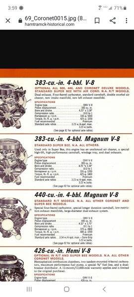

From a Mopar Muscle article: In 1968 and 1969 there were two new high performance versions of the 383 available. The 383 Super Commando was a slight performance upgrade producing 330 hp due to an unsilenced air cleaner and dual exhaust. The best 68-69 383 engine was available on the road runner and coronet superbee. It made, some say underrated, 335 hp thanks to a number of high-performance 440 parts . It received the recontoured 440 heads with larger exhaust valves of 1.74", compared to standard 1.60" exhaust valves. Heavy duty valve springs and rocker arms were also installed and shared the same camshaft as the 440. In addition this engine also boasted a new dual-plane intake manifold with a Carter AVS 4-bbl carburator.
I have seen plenty of confusion when comparing 68-69 330 and 335 hp 383s...and I would not say I know all because mopar did weird stuff, but looking at advertising and researching how they assembled the 383 b bodies all the 330 horsepower were ac optioned cars and all painted turquiose...the 330hp does not necessarily/ likely not have hp stamp on the pad. Both the 330 and 335 were high performance engines with hp exhaust manifolds and dual exhaust with same heads and compression. The 330 was ac the 335hp magnum did not have ac. Not sure if a bee or rr could be ordered with ac??? I will have to look...
69 383 magnum 335hp were painted orange and had larger magnum cam and valve springs, w windage tray and double roller timing chain.
The 383 magnum 335hp was advertised for the road runner and bee are stamped hp and I believe it made it into some of the chargers if it was ordered with no ac or was a 4 speed car. The usual sign of a 383 magnum is a orange engine..(edit 68 turquoise)..but it is unusual to find a charger born with a orange 383...no idea how many since most were turquoise and had ac.
The hp on the block is just a stamp, the block is no different then a 2barrel. On a 383 if you deck the block you can lose the stamp marks completely, so while at the machine shop if you want to keep the stamp...keep that in mind.
383 magnum 335hp were painted orange 68 turquoise, 69 orange and had larger magnum cam and valve springs, w windage tray and double roller timing chain.
The 383 magnum 335hp was advertised for the road runner and bee, and I believe it made it into some of the chargers Not in chargers for 68/69 if it was ordered with no ac or was a 4 speed car.
Seems like there is conflicting info on a 68 383 magnum paint color, some list orange? Some don't, but turquoise I believe is correct...thanks!
I did look it up and you could get ac in a bee or roadrunner it came with turquoise 330hp. It would be interesting who out there has a bee or rr with ac and a 383....that is probably unusual. Our 69 bee 383 auto has no ac and had a orange 335magnum engine. I have heard of a 4 speed 383 charger born with a orange magnum engine... but they should have only been 330hp turquoise engine w 4 speed in chargers..be interesting to hear from someone who had a new 69 4 speed charger or auto no ac ??? Be interesting to here what is out there!
Our 69 charger 383hp auto had ac turquoise 330hp.
