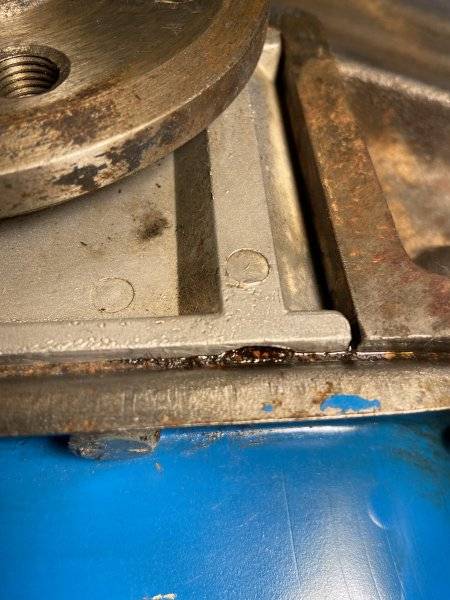

I’m new to my 1966 dodge 383 and all I know is motor was rebuilt not long before I bought the car. My question is does it need a windage tray and any suggestions on windage tray and oil pan gasket. I have to take oil pan off due to leak so any suggestions are much appreciated. Thanks

I need to fill the bolt holes for the main that’s we’re my leak is so I’m dropping the pan
The bolt holes in the rear main seal aluminum retainer are not causing any issues, and definately do not need to be filled with RTV (you won't like the result the next time you need to remove the retainer!!) There is plenty of gasket sealing before the bolt hole starts. The side seals look dry, but could be seeping a little. Snug up the pan bolts and see if that helps.
