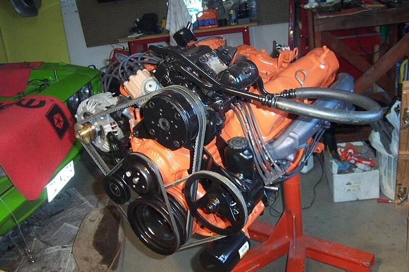

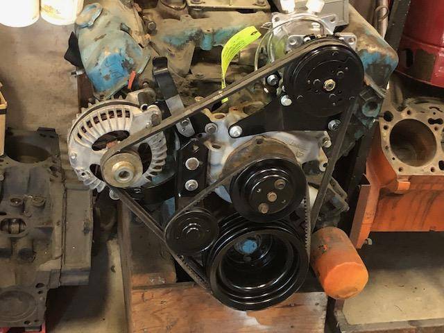

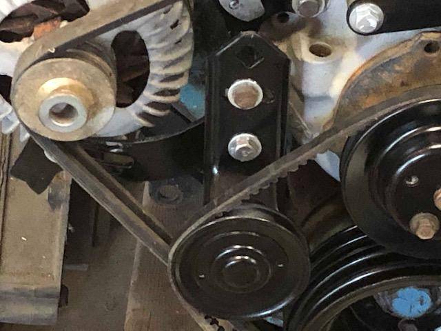

Is the pulley alignment correct with the six cylinder pulley. Sounds like an interesting idea. Do you remember the diameter by any chance?
This is a 440 with A/C but the power steering pump is not in place.
This is with the pump in place.
Non A/C with no power steering may have had a 2 groove crank pulley IF a single groove was not available at the time the engine was assembled. I have read that it was common for cars to have upgraded parts if the standard parts were not available at time of assembly. This kept the assembly line moving.
