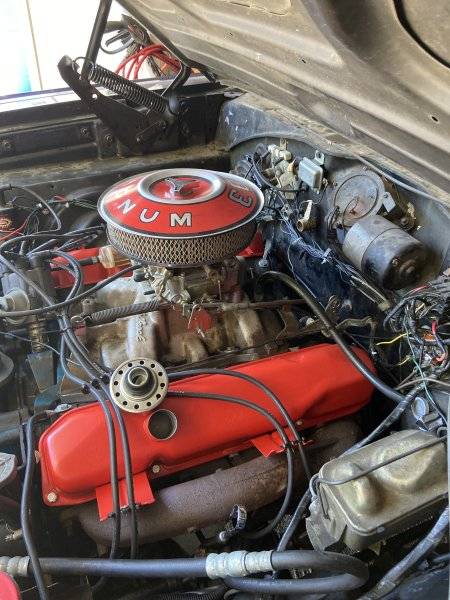

Loulang,
You can see the PCV/ hook up in post #39. PCV has hose attached, sticking out of pass side valve cover. Hard to see, but hose should go to carb base, rear.
This is how you hook it up. Can go to either v/cover. Hose usually goes to front of carb, in the base, 3/8" fitting. PCV should rattle when you shake it. If not, it is gunked up & needs cleaning.
