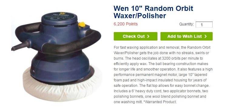

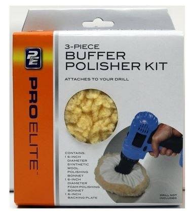

Looking for something to use at home that can speed the job up rather than doing it by hand and was looking at this. Anyone have one of these or use something similar?
Thanks in advance,
Roger
Depends on how much you want to spend. I use a Porter-Cable Orbital. Get my stuff at Adams polishes. Not cheap, but reliable for years. Less likely to burnish a spot with an orbital.
Not looking to spend much at all. Might go for the hand held applicators that have a handle on them also.
Depends on how much you want to spend. I use a Porter-Cable Orbital. Get my stuff at Adams polishes. Not cheap, but reliable for years. Less likeley to burnish a spot with an orbital.
Rebel, the problem I have found with the polishers that go on the drill is that they do not go fast enough to 'cut' into the material. 3500rpm is the optimal speed you would want, and most drills only go to 2800 or so.

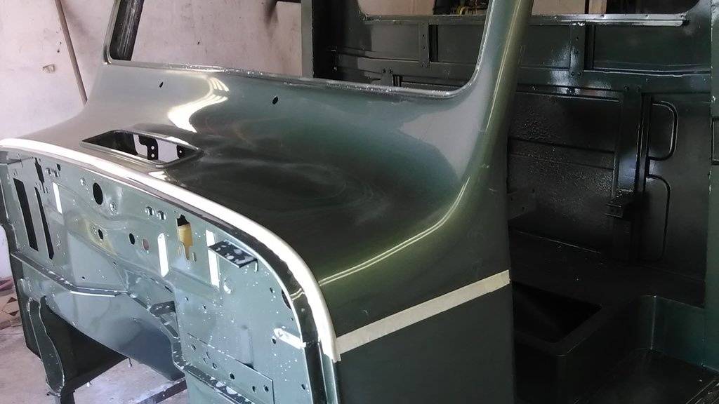

For waxing, the orbital shaker & clean microfibres for hand follow up. For cut polishing with compound, rotary. I never turn more than a 1000 rpm. I keep surface temp down. @ present i'm color sanding & polishing fresh paint on some old Willys pick up body pieces.

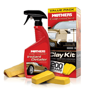

Lots of good stuff out there. Adams, Griot, Meguiers. Whatever you use, start with clay bar. First. Use it on everything. Keep it lubed and its easy. Watch a how to video.

Honestly! You may as well polish by hand. Drill mount buffers? Crap! Wen buffers? Garbage!
Do it by hand and save throwing money away while you build up your bicepts!

Mothers Claybar {like Dennis said} is a great idea too...

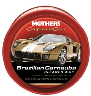

Stopped by Pep Boys with my youngest son tonight while my oldest son was weight lifting & bought this kit as well as the wax. No need for the cleaning wax with this kit. Thanks for everyone's input!
Read clay instructions. Gets easy after handling a while. Take before and after pictures as we expect results.

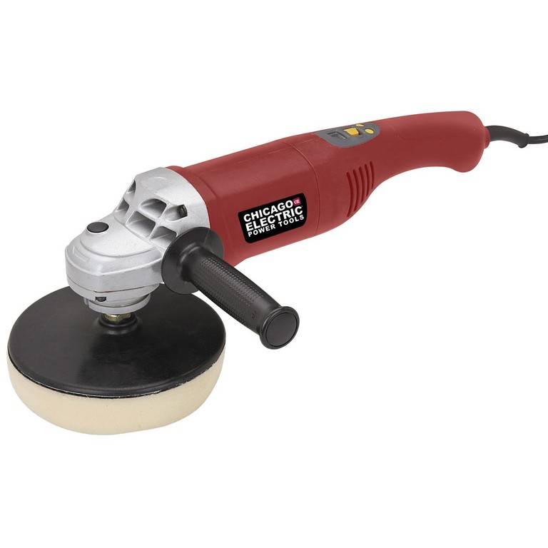

I had one of those random orbital polishers and gave it away. They do a good job, but by the time you're finished your wrists are numb from the vibrating. I went to a variable speed polisher from Harbor Freight.
The foam pad can be replaced with a wool bonnet for buffing. I like it MUCH better.
