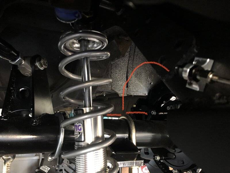

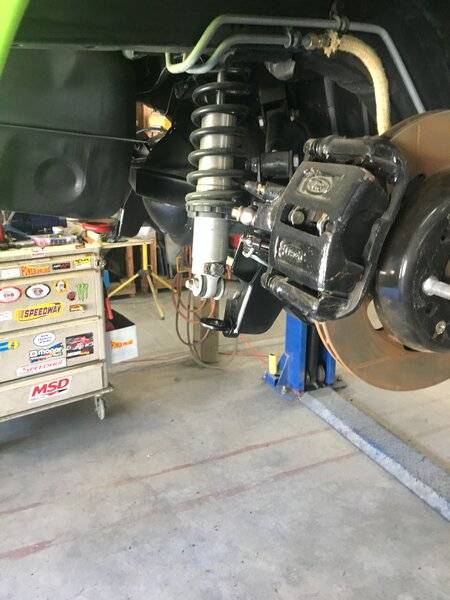

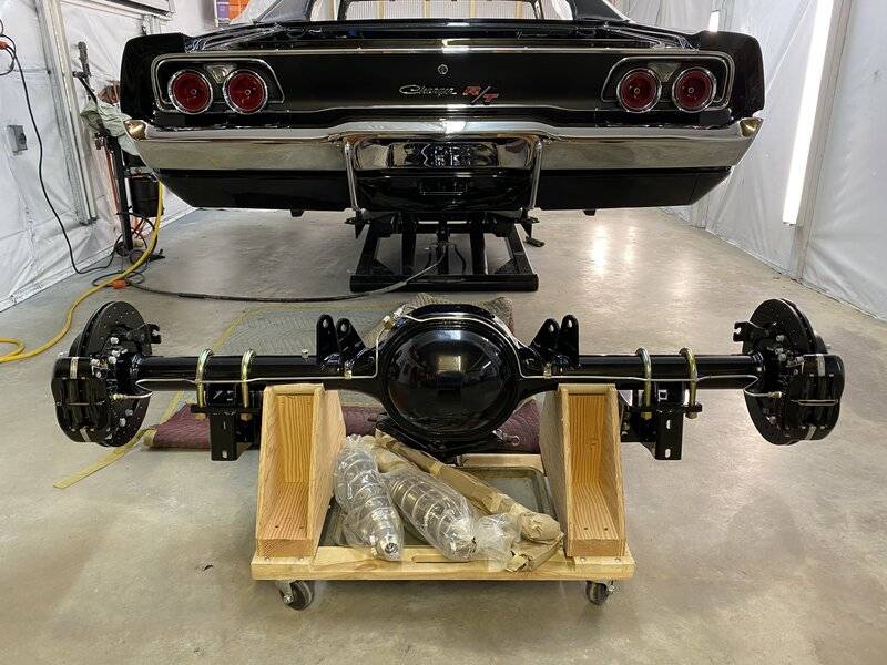

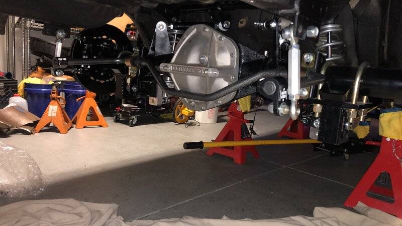

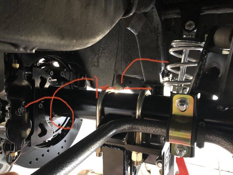

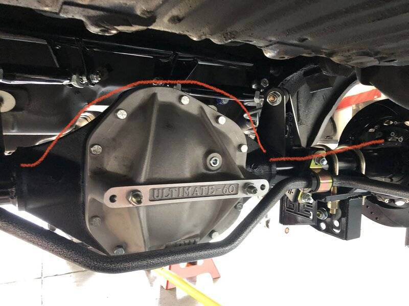

Hey all,
So how have you guys ran your rear brake lines around 4 link setups. I have limited room with my Gerst 4 link and sway bar setup. I’m not sure I want to run it up front. I’d like to run over the pumpkin etc. planning on bulkhead fittings with hardline and flex line to the calipers. Thanks all.
I don't have of the brake lines specifically, but here are a couple of the rearend in which you can see some of the brake lines.
