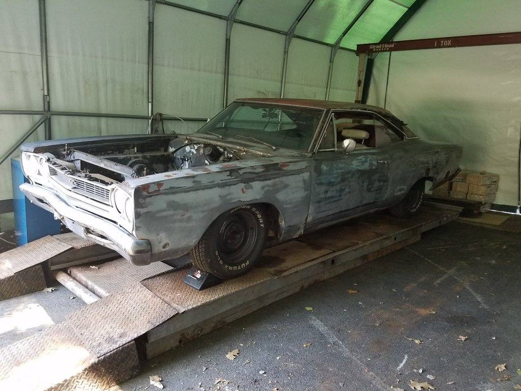

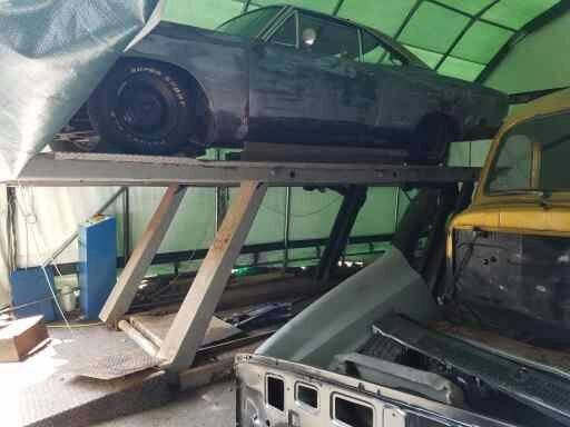

not a four post but i love it. I have a parallel lift i found on craigslist for $800. theres alot of good deals on there and you find a shop closing, or in my case a guy who had it come with his house and doesnt give a rat's *ss about cars. being a parallel lift, it can lift 11,000 primarily set up for alignments, but plenty of under side clearance for all work. the only down side is you cant park underneath it. but its built like a tank and was cheap enough. as you can see i have mine outdoors in a tent garage. on just blacktop. i cant mount any sort of lift on blacktop obviously, so this was perfect as i just sit it there not anchoring or anything. obviously no warranty on craigslist but it was a steal this type of lift is what they use for military trucks, 20 yard dumps, city busses, big wheel loaders etc. just check all the welds close and youll be fine. heres one of it down, and a crappy picture of it raised. but plenty of room underneath. alot come with rail jacks to lift the wheels off the runways. mine didnt have them, but i put 10in channel across with bottle jacks, works for me but if i had the money, i would still put in a concrete pad and get a 2 post, clear floor asymmetrical lift. even for storage its fine to park a car underneath, but you absolutely have full access. . i had one i also got for $800 on CL but without the fund to putin a pad it was useless... traded it for a 1940 farmall. 4 posts are expensive, i bet you can buy a two post adn have a pad poured that you can anchor to and be cheaper then some 4 posts

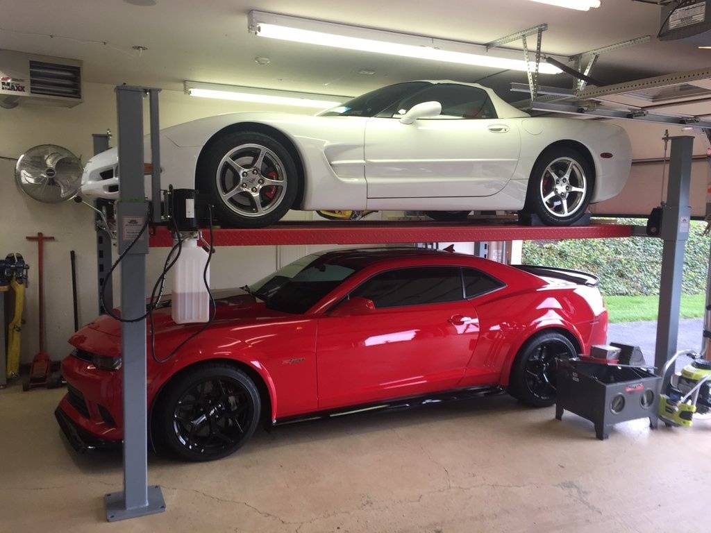

No flaming me since these are Chebys on the lift.
Hehe. Ladiesand gentleman This is the only time the cheaper the lift the better. Preferably bargain basement chinese made of aluminum foil. The lift collapses, corvette crushes camaro and with a little luck, the 4 posts fold in, crushing the vette. Win win
