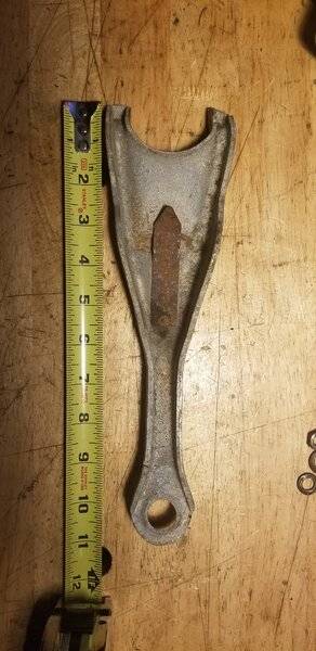

A few questions for the 4 speed experts. So I'm in the process of converting my 68 charger from a 318 /904 to big block 4 speed. I've been collecting parts for the conversion for some time now and have started since I seem to have a bit more free time now. First question is the shift fork, not sure if I have the correct one. The bellhousing is an 11" P# 2892262, I attached a pic of my current fork with an appox. overall length of 11 1/2 ish". Is this correct? Seems everywhere I look online they are 10 1/2 or 12 1/2 with no mention of a 68 b body. The other question about the shift rods and levers. The trans unit I have is a A833 OD that fits perfectly into the bellhousing (I believe the bearing retainer has been turned down). Just not sure on what rods and levers to use. The trans did not include any levers. Can I just order a set of rods and levers for a 68 b body? or do they have to be specific for an OD unit?

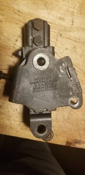

Will this shifter work? Its a hurst 3914076? Sorry for all the questions, never had any experience with a manual transmission before kinda learning as I go.
That is a 10.5" clutch fork.
Get a new Hurst shifter, you will thank me.

Wasn't really planning for authenticity just yet and may consider it in the near future. What about the fork? Will this 10 1/2 be ok with my bellhousing?
Btw, I once changed a 70 RR from 10.5 stock bell housing / flywheel etc to 68 11”. Used the same clutch fork.
Its pouring cats and dogs out today. Tomorrow I'll dig out the throwout bearing, bell and trans and mock up the fork and post some pics of its fitment. If the rain lets up then maybe later today.
You have a Hurst Competition shifter....if it's in good shape then I'd just run it, if it has any questionable issues I'd send it off to be rebuilt.
