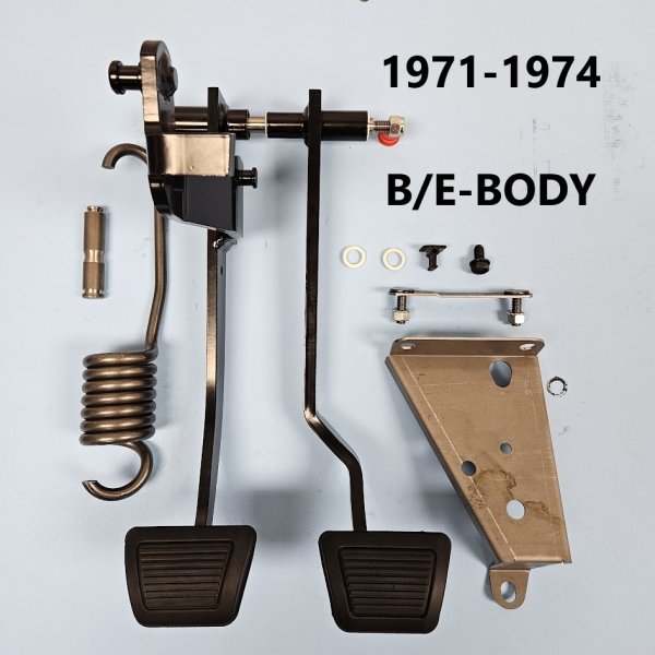

What other 4-speed pedal assemblies for a 73 Charger? What other years would use the same assembly/ I know they differ from A to B to C to E body, etc… but what other year of B Body pedals would match? Thanks.
Would a set off a '67 B body work on a '73?
71-74.
There are slight differences (like the pedal shapes- rectangle vs trapezoid).
Thanks. I'm not too concerned with pedal shape. Will the assembly fit the '73?
You need to use 71-4 B or E body pedals. We make the 71-2 style.
1970-74 E/1971-9 B-BODIES REPRODUCTION CLUTCH AND BRAKE PEDAL KIT-FOR 18-FINGER DIAPHRAGM PRESSURE PLATE - Mopar A833 4-Speed Transmission & Component Specialists
