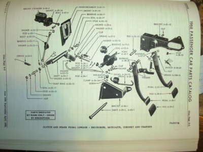

Here is a pic out of my 68 coronet manual, showing the complete set up, should be same for RR. The clutch pedal part # is 2823607.

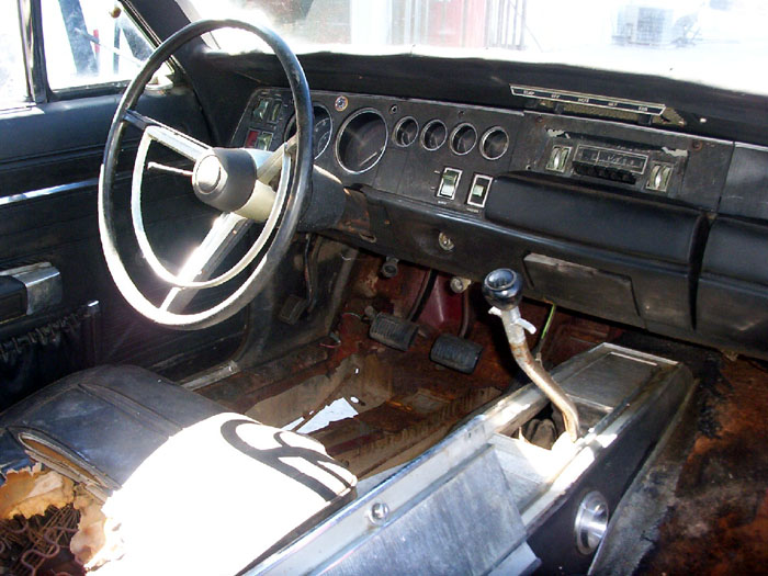

Here is photo of what it should look like. This is an original '68 Charger 4-speed.
Dan
