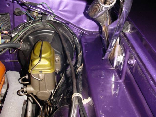

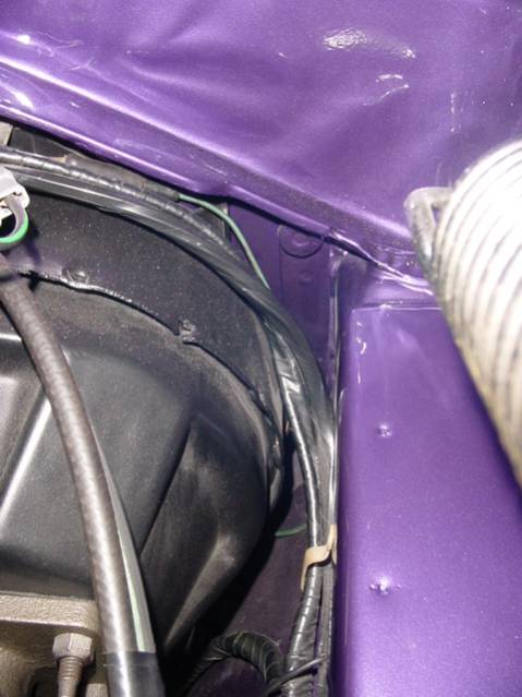

RT
Hi : I know this may sound a little duh!! but check to make sure that the two stud bracket for the clutch pedal ,that goes through the firewall between the mastercylinder and the inner fender, has been installed properly, like welded to the fire wall ,so the pedal assembly works as one unit. This is often left out on a convertion as it is very difficult to install properly when everything is in place. Here`s a couple pics. You can only see the top 1/2 part of this bracket. Hope this helps and i`m going to watch this one to see how you made out. Fred
