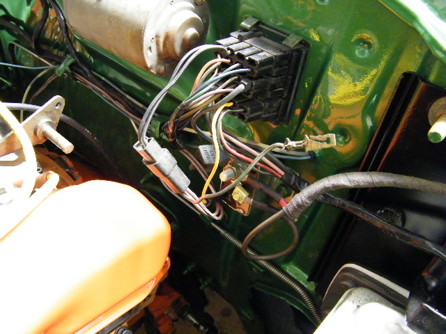

I'm converting the Pickle back to a 4-speed & the wiring harness that goes to the trans switch has this one extra wire, which I assume feeds the under-dash reverse light through the bulkhead disconnect. Not having a 69 service manual, the 64 dollar question is; what is the correct socket that this goes into?

It plugs into the lower right socket of your forward light harness (in your pic). The reverse light plugs into that socket on the dash side. Just got done doing that on my 69 bee. Works like a charm.:headbang:
Funny this is that I just figured out last weekend why my reverse lights weren't working. It appears that I'm missing the very wire harness of which you show and talk about! Now...where to get one...
