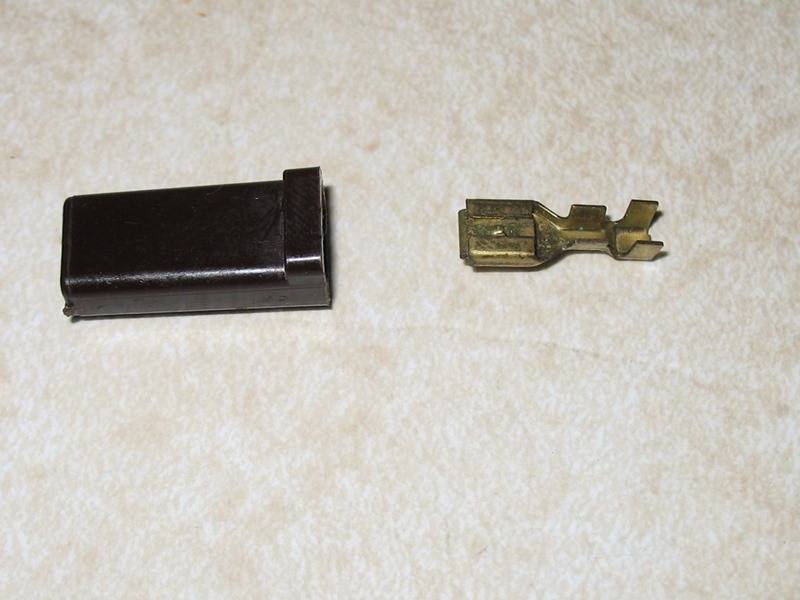

The only difference between a relay for a manual and an auto transmission is a manual relay has an integral ground. You can use one for an automatic by adding a ground wire to the connector for the neutral safety switch. Otherwise they are the same relay.
Did it on a '65 Sport Fury. Used a DIY plug on one side of a short wire and a ring connector on the other side. Attached the ring connector to ground using a near by bolt.
