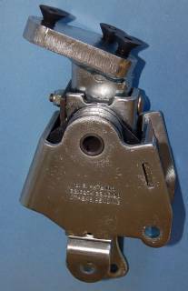

I'm reviving an old thread here, but i'm trying to determine what to do with my 68 Charger that's been converted from the Inland to the Hurst shifter. Ill either add the light I have, or change back to the Inland. I have a build date of B03 (November 3) If your Road Runner didn't arrive until April with a Hurst shifter and no light that tells me the changeover was on or about when your car was built. Do you have a build date? unfortunately it appears mine would be way to early to call it a Hurst car.
If you want the original looks, you can get the best of both; a Hurst new shifter mechanism that accepts the Inland shift lever. The reverse lockout won't work, but who cares.
http://www.brewersperformance.com/products.php?cat=50
I've heard about these, and that may be the route I take. id sure like to keep the Hurst, but my car is just to early to fool anybody. Ill ponder it some more before drilling a hole in the dash for the light.
