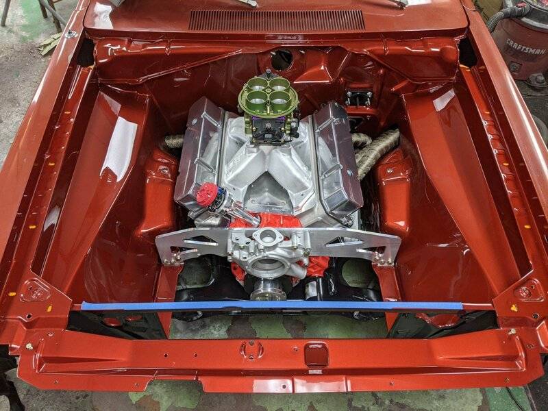

You can run a Indy single plane with the 270’s. That’s what my buddy does. And that’s about it… lol
Indy intake on my TF 270 headed 470.
Hood clearance might be a issue if you don't have a scoop, the Indy intake is tall
What brand/type front suspension on your buddy's car? looks like he has spent some time cleaning up the inner fenders-interesting.
Mike
it’s all stock suspension. Yes, he did a lot of work on the engine compartment.
