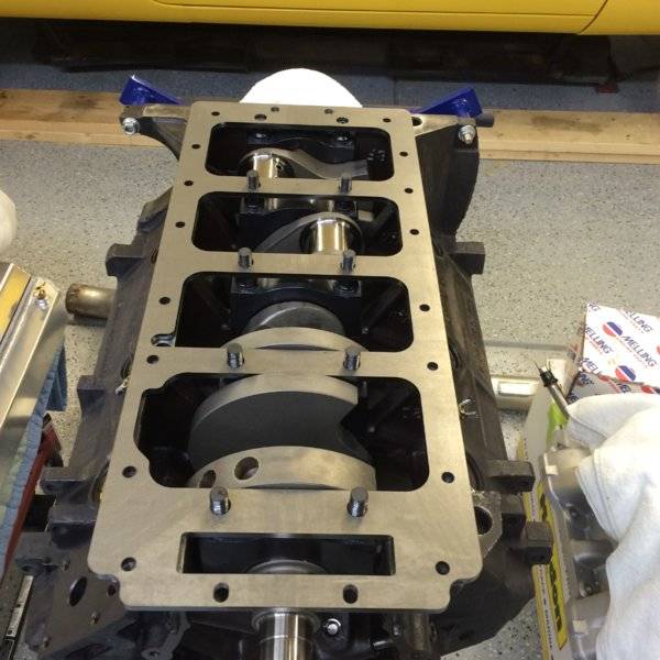

      I’ve used a few of them with stock caps on 400’s. Until I tear one down I probably won’t have an opinion on how well they work on the mopars. They certainly don’t hurt though.
      This is my 511 in the roadrunner

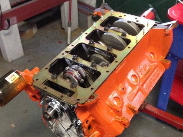

        IMG_0902.JPG Been running one on my low deck 500 for 4 years. Just for my peace of mind i guess. One tear down mains looked perfect.
