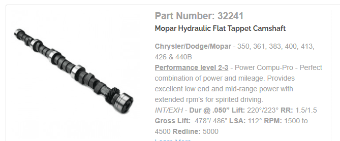

Check out this cam currently for sale on this site. Very similar to the one I used in my 400. Great street manners and power. Don't believe the powerband, it pulled past 5000.
My OEM 383 2bbl cam would go to about 5000 RPM before it gave out. As I became a drag racer I was looking for 7000+. I should have been satisfied with 6500 to save my cranks.
