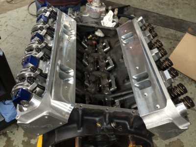

I´m running pretty the same.
400 block with 440 source 500 stroker kit.
TrickFlow 240, Mopar M1 single plane, CR around 11,84, TTI 1 7/8, rest 3".
Don´t have cam specs in mind now but a relatively mild hydraulic roller with 1,5 Comp roller rockers.
4 speed and 3,55 gear.
Was not too noisy.
After about 8000km I have cylindergasket failure so we disassembeled the engine.
Was some wear from water and a little washed out from the Quickfuel but no signs from a piston kipping in the cylinder.
Ran strong with more than enough power for fast country road cornering and reved like a motorcycle;)
