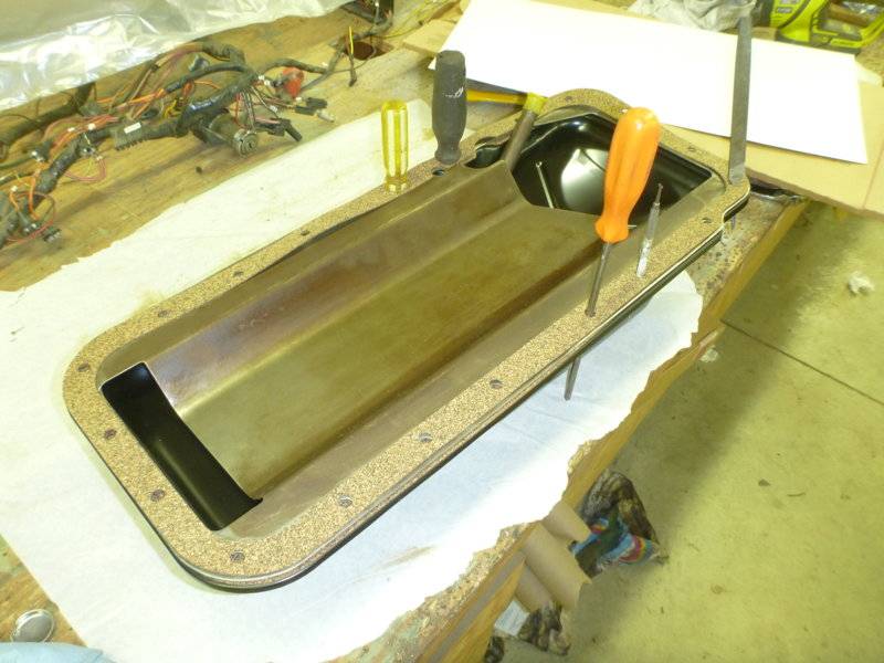

So to all you engine gurus out there, does the big block '402' oil pan need the additional Mopar performance or aftermarket baffle on it, or is the baffling inside the pan sufficient ?
Do you mean the windage tray? It's there for a reason..

Unless you are aiming for a 100% restoration, why go with a 4 quart pan? Why not use the street Hemi 6 quart?
What are you going to do with it? Drag racing? Use the tray. I plan on using the 402 with a windage tray, just because. When the car is done it will make a few passes at the track, then hopefully get miles put on going to car shows.
Just using it as a street car, cruising, no dragging. Just seems like the windage tray is overkill when the pan has all that inside it.
Tray keeps the crank from sucking /throwing oil up into the rotating assembly, but if you think it's overkill why bother asking.
The plates in the pan itself are to control oil surge. The windage tray has an entirely different purpose.
Without windage tray most of your oil will be whirlpooled around rotating assembly not being picked up and pumped throughout engine. That clear it up for you?
You don't need one. Pan baffles keep the pickup covered under acceleration and braking. The tray keeps the oil from getting aerated (foamy) by the rotating assembly. Plenty of factory stuff, Mopar as well as other brands didn't have them. How efficient they actually are under 'normal' driving conditions is debatable, and oh boy has it been debated! They definitely don't hurt anything, I prefer to add/enlarge slots for better oil return. The folks that are truly concerned about controlling oil in the pan usually use a crank scraper.
On a BB Mopar, I always use one with any stock or stock-ish type pan.
Yeah me too, needed or not ....I use the same one I've had for years. Being slightly younger and dumber about 15 years ago I was cleaning it up with a wire wheel, no safety glasses. Had to get a piece of metal wire pulled out of my eye with a big magnet. Needless to say, I've been "sentimentally" attatched to it ever since:D
He won’t need it going from his intended use of the car.
How many cars have we driven without one and the oil doesn’t get foamy. 383-2bbl, 440 low Perf on a C-Body, etc.
Many drag race only guys don’t use a windage tray at all and only use a crank scraper. They dyno test everything and this is their best case for most power.
If a pan is very deep a windage tray may not be necessary but on shallow pans my feeling is they do more and on most street wet sump systems I fit one.
