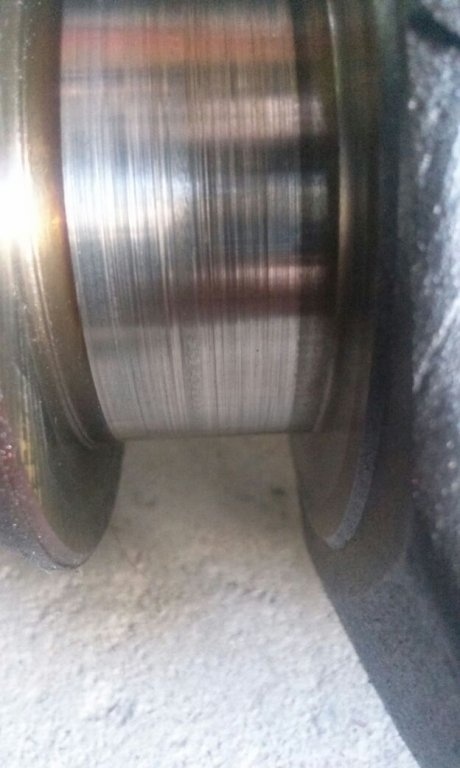

Dissasembling my engine, found a problem on mains. It seems they would need to be resurfaced. They are standard but don't want to cut them 0.010" if is not necesary. HOWEVER found somebody is selling these Mains bearings with PN 4094 M2 on box and seller told me they got stamped the L002 numbers. Seller claims that means is 0.002" undersize. Is that true ? I could get my mains "resurfaced" to that size and will save from cut to 0.010"
Mechanic told me it could be polished and install fresh standard bearings again without problem. It looks uglier that really is. Barelly can be feel some irregularity. But preffer to resurface them at .002 since found available these bearings.
Of course if the PN and stamped numbers really confirm these are .002 undersize

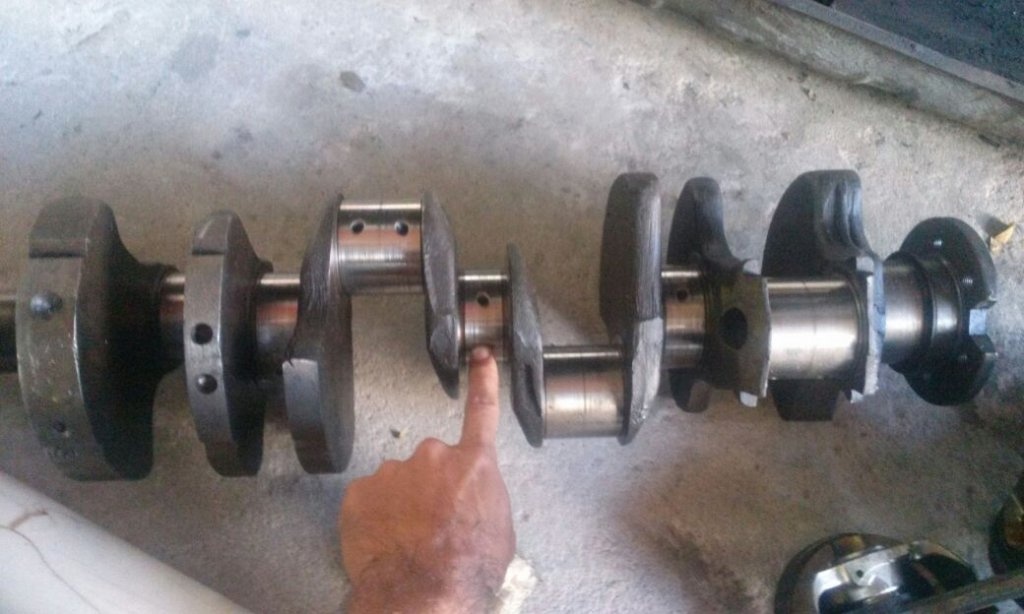

A mechanic told a polish an fresh standard bearings will hold but I preffer IF 002 cut is posible the get a new ground job on them. The pictured main journal is the worst of all 5 and is the number 3.

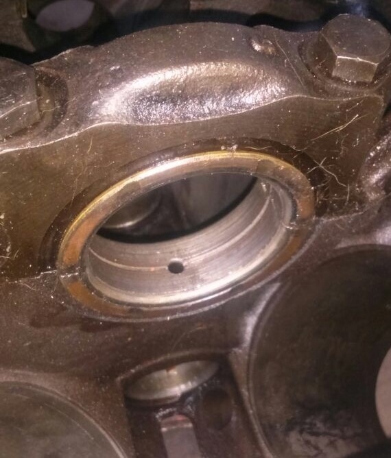

Appears to be a steel (forged) crank. Overall it looks like normal wear on it, that bearing is another story.
A 'complete' measuring on the crank will tell the story, if it needs to be ground, or just a good polish. The journals must be round, and straight, and be that after any work.
Yes, is forged
