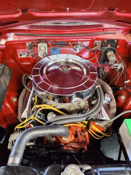

I have a 64 Belvedere wagon with 413 and later HP exhaust manifolds. They will work with custom exhaust or order TTI for the manifold casting numbers.

Thanks for the response guys!!!! He's offering the 69 Roadrunner set at a pretty good price and said he had a later model set that he would let go of even cheaper. So, I'm going this weekend to check them out. I will be coming back with at least one set hopefully. Nice looking wagon Max!!!!
