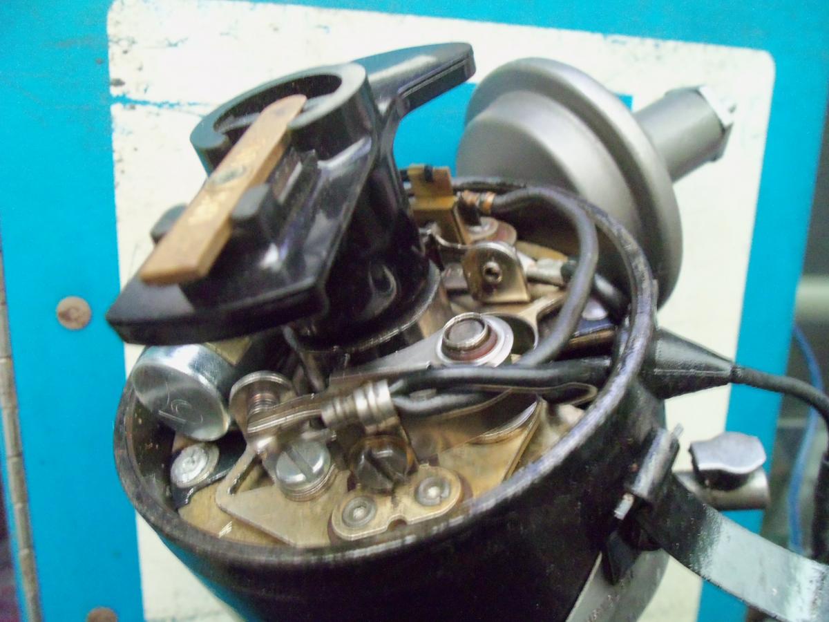

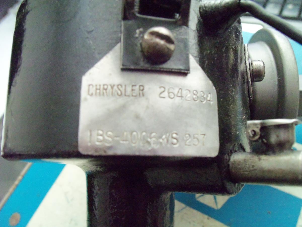

Been looking for a presolite Dual point distributor for a while with very little to show. I just found a 1967 NOS Hemi Dual Point distributor for big $$$. I been told it will match my 440HP 4 speed. I still have questions. 1. is their a different in the timing curve?.2. Is this a good deal..3.is their anything else i need to know for the install & setup..Thanks guys

I'm sure the timing curve is different. The 440 HP one would be an IBS-4006ZS (or YS with CAP).
