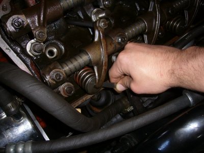

Ok, as my camera failed at first attempts, I am now able to provide you the Pictures of WHERE at the valvetrain I measured the valve-lash.
The concrete pic shows valve-lash-measuring at cylinder #1 EXH-valve.
Did I do anything wrong in measuring?
