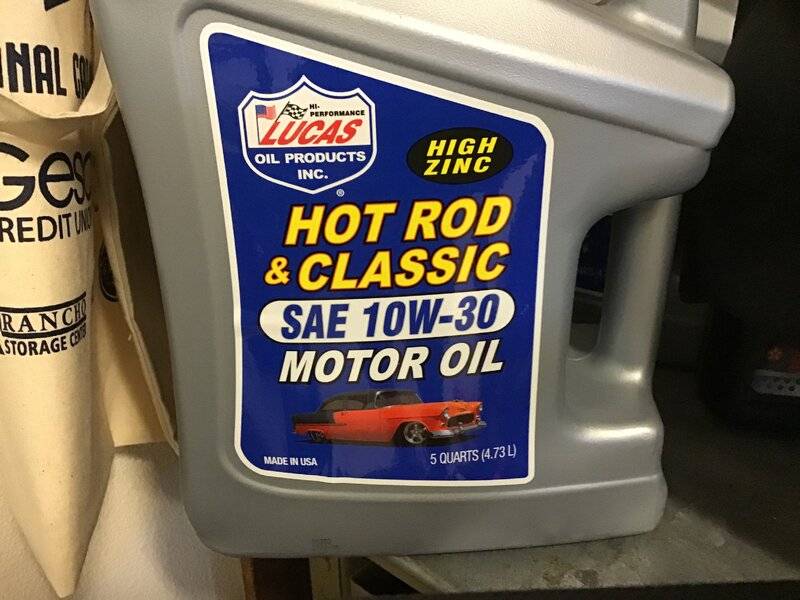

I’ve been running this in both my Hemi car and my 383 car for a couple years now. No complaints.

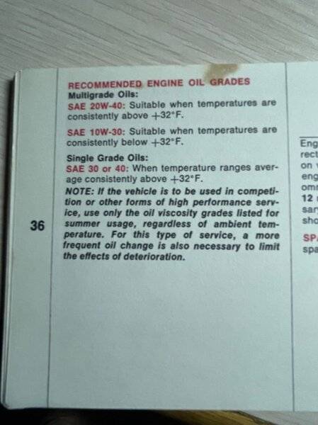

I don't have a Hemi owners manual, but I do have a 1972 Plymouth Road Runner owners manual. For the 440 at 32+ degrees 10w-30, 10w-40, 20w-40, 20w-50, 30 are all acceptable. For maximum performance driving 20w-40, 20w-50, 30, 40 with Mopar High Performance Sulferized Ester #3683842. I use Valvoline VR-1 Racing 20w-50 conventional. The engine is original with low miles and not rebuilt. If it was rebuilt, I would use the same oil in synthetic, or what the rebuilder recommended if he had a specific choice. Both VR-1 oils have plenty of zinc and phosphorous for flat tappet engines.
Back in the day they rec'd straight 30. A lot of warranty engines back then lol

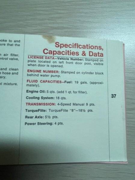

My 67 Hemi Charger glove box manual, see photos attached, states the recommended oil at specific temps. Also the capacity is 5 qts.
