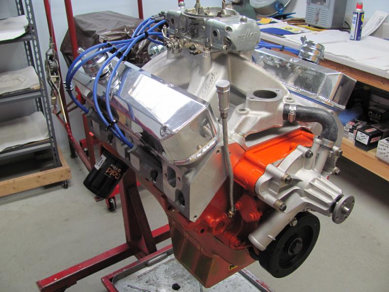

What I like about it is the little POS never gives up. Yep, 91 octane pump gas.

RPM...........TQ/HO
3000........450/257
3500........484/322
4000........499/380
4500........545/467
5000........557/530
5500........534/559
6000........510/582
6100........504/585
6200........497/587
6300........497/596
6400........486/592
6500........477/590
6600........466/586
6700........457/583
Good looking engine with some great dyno numbers. ;)

It's a 360 with BPE stroker kit. 4.042 bore and 4.125 stroke for 423.5ci but 426 sounds better. 1050 RS Race Demon 4150, Edelbrock Victor Intake, our ported ProComp heads, 10.9:1, 91 octane, our custom Comp solid roller, MRL pressure fed roller lifters, Firecore50 distributor.
I was suprised when we removed the 850 Mighty Demon in the picture and went to the 1050cfm Race Demon and we picked up 30 lb-ft of torque in the 3400-4000rpm range and 25 lb-ft peak to peak.

So now it has a very special set of our Indy LAX heads on it and 574 lb-ft and 629 HP.
