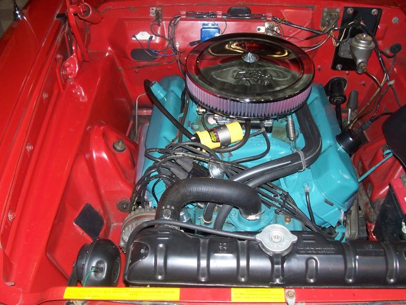

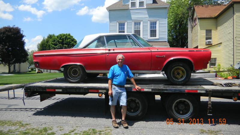

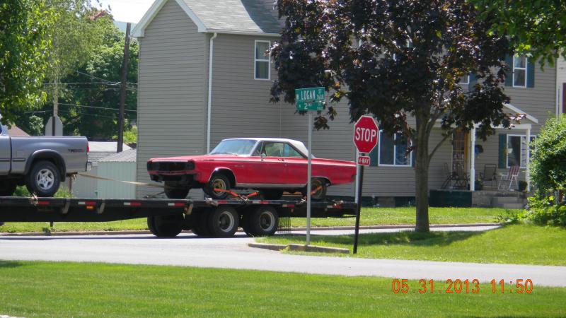

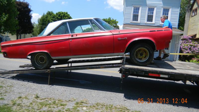

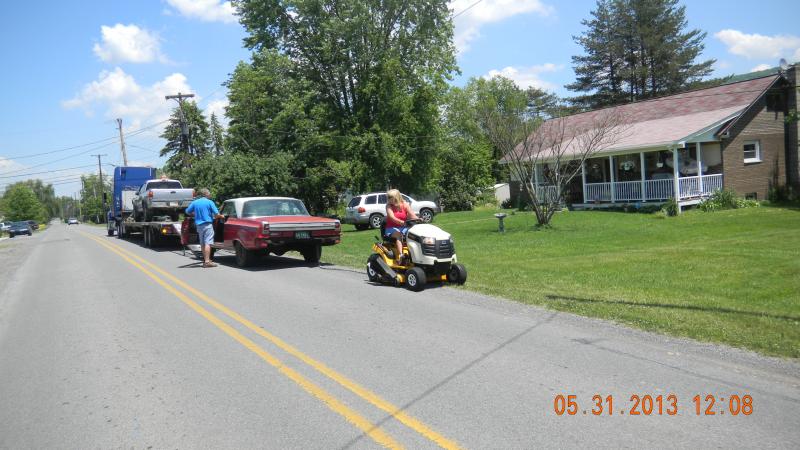

Hello All, He is a few pictures of my dodge coronet Enjoy Dave Ldodge coronet 147.jpgdodge coronet 148.jpgdodge coronet 149.jpgdodge coronet 150.jpgdodge coronet 151.jpgdodge coronet 152.jpg

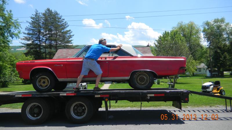

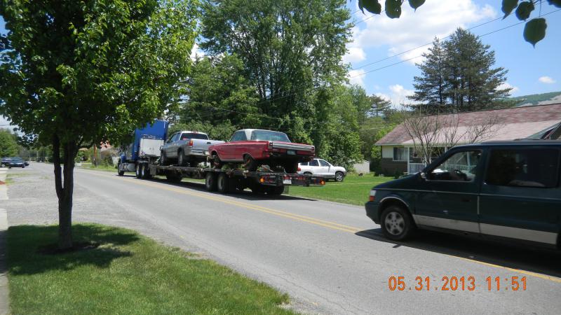

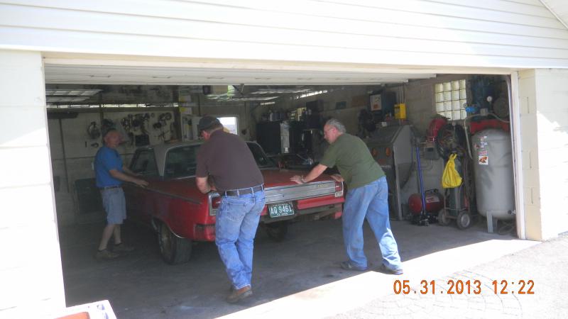

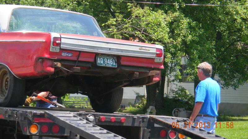

dodge coronet 155.jpgdodge coronet 159.jpgdodge coronet 165.jpgHello,I just waned to show you people how close this truck was from falling off.I bought the Dodge and had it trucked to Pa,It was alot cheaper than going after it Anyways the truck driver had a truck that he used for a winch to get the car on board.and to unload it.A little more rear end play and it could have been ugly.The wife and I towed the car to its new home.Lucky for me a couple of my friends stoped by a gave me a push into the garage,Dave L
