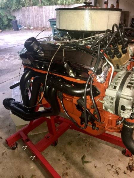

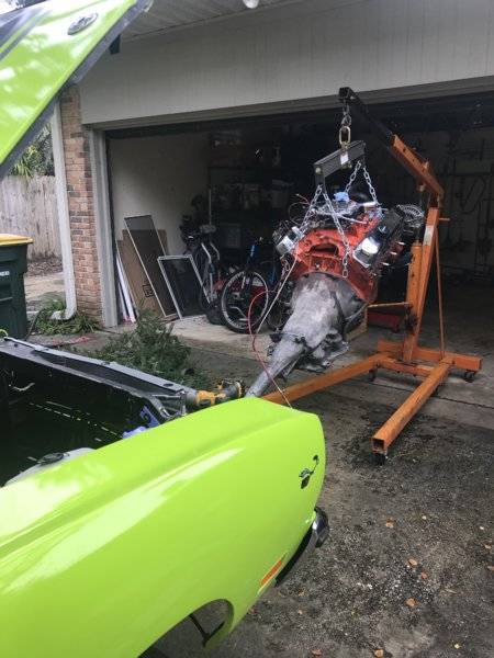

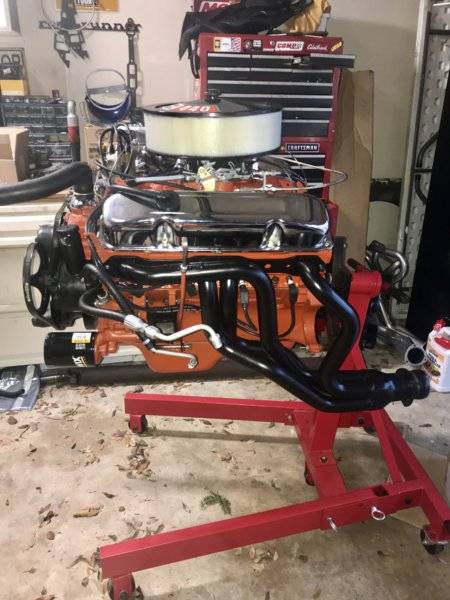

Weather permitting, gonna try and get the 440/727 installed in one piece. Before I get this monster in the air, a few questions:
-do I need to remove the steering linkage behind the K member?
-any chance I can install the headers first then install all at once?
Car= 1970 Belvedere.
Note I have a mini starter, a Borgeson small ps unit, a Lokar kickdown cable, and a B&M shifter- i.e. no hard factory linkages in the way.

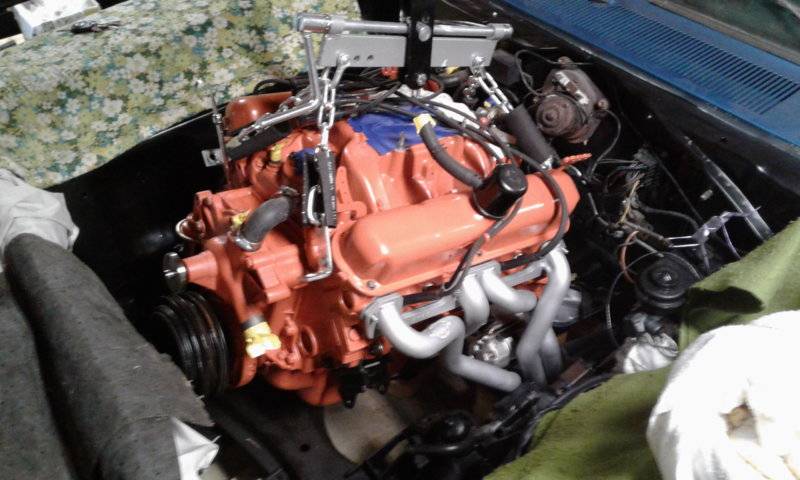

Congrats on the pending engine drop. I just put the new 340 in my 68 Coronet about two months ago. It's an exciting moment for sure.
About the installation, I didn't have to remove any steering linkage, but that's with a small block. You'll probably not be able to install the headers first though. I had to (mostly) install the engine/tranny with the headers laying on the fender wells. Lay a couple blankets on the fender wells, lay the headers on the blankets, and tie them back with string or twine. When the eng/trans is down far enough, untie the headers and guide them onto the engine.

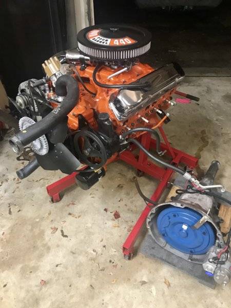

I pre installed the mini starter and wired it up (disconnected it from bulkhead) on the transmission before I bolt the trans to the engine tomorrow. Is that a problem?
Starter definitely has to come off the transmission before installation unless maybe you're installing the engine/trans at the same time? I've installed big blocks in my '70 about 6 times and never did the engine/trans at the same time, so I'm not sure. I usually put the trans in first & then install the engine/headers/starter as outlined in my last post.
Got it. I’m definitely doing trans and engine together.

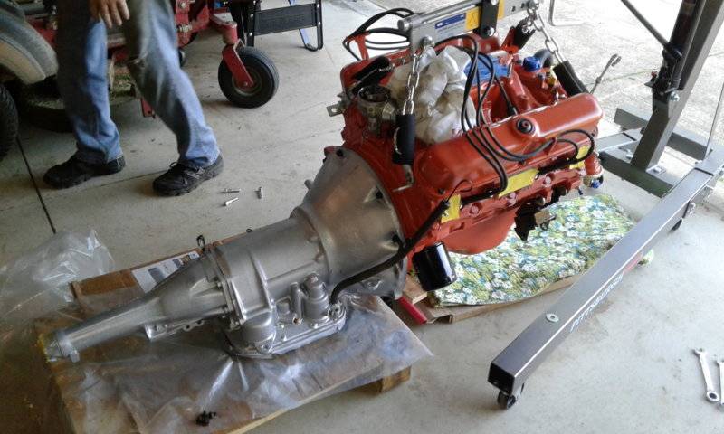

Having had 440's in and out of my GTX three times in the last few years (and I'm running the 4 speed!), if I may:
(This is a 2-man deal! Don't be an Ed, do it safely!)
1. Headers need to be in the car, laid over in the inner fenders (something behind them protecting the paint!)
and not connected to the rest of the exhaust.
2. It's perfectly fine to have the starter already installed, especially if it's a mini. Mine is a stock Dakota starter, which is
a bit larger than the mini starters out there. Fits fine. Heck, wired up is even better.
3. You are going to be laying the tailshaft of the transmission back at an OBSCENE angle in order to clear things and get
it under the firewall, hence the 2nd pair of hands. Slow going!
Go a bit, adjust things, protect things, go a little more. Be ready underneath with a "ride" for the tailshaft once it's
down there enough because it's going to head for the floor quickly once under the firewall.
I've used a creeper, a floor jack and a transmission jack for this.
Anything stout enough for the job will do, but this is a must.
4. Make sure your helper is still alive under the car and that the tailshaft housing is still riding on it's makeshift transport.
Once the engine/transmission is substantially clear of the firewall and radiator support, get that trans crossmember ready
to take the place of your tailshaft buggy.
Loosely get that thing started on the transmission and use a floor jack to get under it; raise it up to mate with the
car crossmember and get it started over that.
Once there, final cha-cha can commence between getting the trans crossmember bolt holes lined up and those for the
engine mounts.
It's like building a big ol' model kit. Protect the firewall and protect the humans.
The rest will become readily apparent. :)

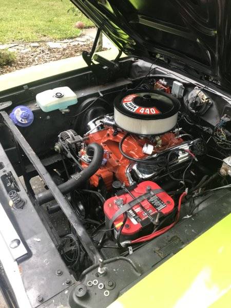

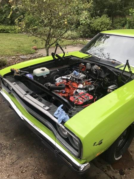

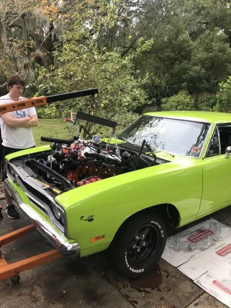

Update. Engine went in flawlessly except A header tube is hitting the torsion bar keeping the trans mount from aligning by 1/2 a hole. Stopped there and called it a successful day. I’ll raise it up and bash it later. Thanks for all the help the last 3 months. Hope to fire it off soon!
