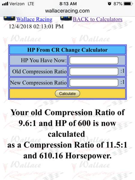

Here’s a calculator I like to illustrate the difference. The possible increase in octane requirement and timing sensitivity isn’t really worth it for a minimal power increase. IQ52 proved all this if you go back and read all his exploits with low compression combos on the dyno...
