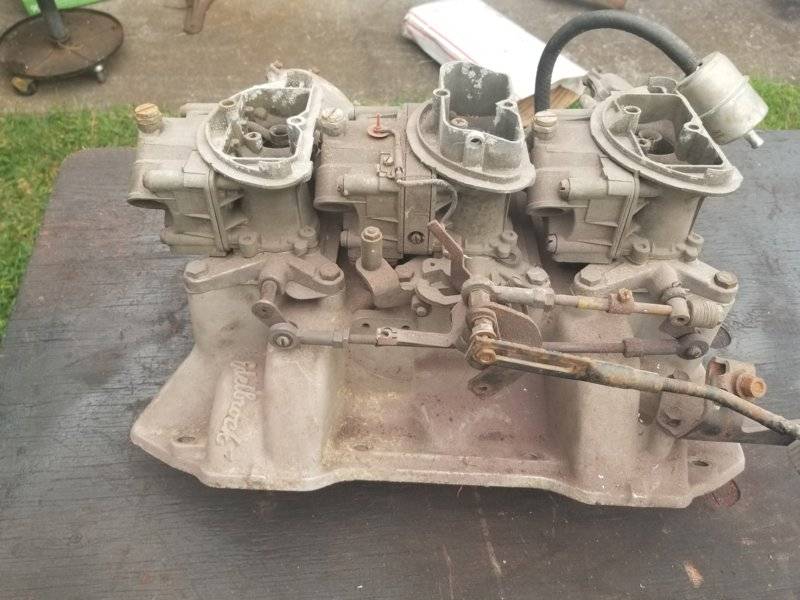

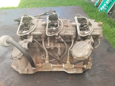

Aloha, I just scored ! 440/6pac intake and carbs. I Need to rebuild ! Need a good place to get carb. Kits ? And any help would be great ! Mahalo, C

Aloha, I just scored ! 1969 1/2 Charger 440/6pac intake and carbs. I Need to rebuild ! Need a good place to get carb. Kits ? And any help would be great ! Mahalo, C
View attachment 821103 View attachment 821104 View attachment 821105 View attachment 821106

Same kit for all 3 carbs ? or 1 kit for 350cc and 2 for 500cc ? sorry new to me ?
All three six pack carburetors are holley 2300 series...
You will need one for each carburetor, so a total of 3 should be ordered to rebuild all three carbs...
also was told center carb needs a bigger plunger ? so carb not bog under throttle ?

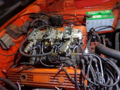

Those have had a little customizing done to them, 50cc accelerator pump on the center carb & the outboards have mechanical linkage.. Vacuum pods are still there, choke is gone...
These days Holley doesn't sell the kit anymore, use to use two kits to rebuild three carbs...
Try this link..
https://www.ebay.com/p/Holley-mopar-Carb-Rebuild-Kit-for-Six-Pac/2111265635?iid=292300633669
The mechanical linkage could be the source of the "bog"... When you try to open the outboard carbs with mechanical linkage and still have the vacuum secondaries, you are going to have problems... That could be why they tried to put the larger 50 cc accelerator pump on...
I would also put the stock 30 cc accelerator pump set up back on... Then if you still have any bogs off the line, start by trying to change the squirter and then try changing the accelerator pump cams in the center carb....
I would take the mechanical linkage off of the outboard carbs and get two holley vacuum secondary spring kits and install the small yellow spring in the outboard carbs so they open sooner under vacuum...
Get them back to stock configuration, but put the a lighter spring in the outboard vacuum pods...
Those have obviously been worked on by someone who doesn't understand how Holley carburetors work...
Holley has many videos online to help you understand how to set up the carburetors... Do a search to find them and learn how the carburetors work and how to tune them...

No, the reason that the carbs bog are they are trying to open them manually with no accelerator pumps on them... If you want to convert them to linkage and open manually, you need to get rid of the vacuum pods and have accelerator pumps with squirters...
trying to open a vacuum secondary manually without a secondary squirter is going to cause problems and bogs...

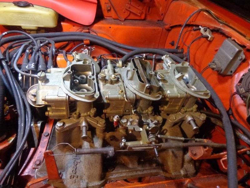

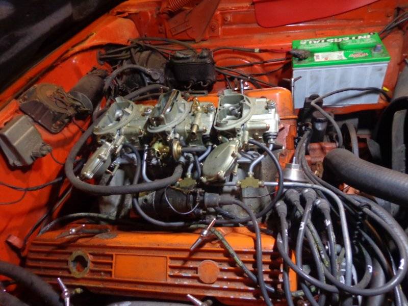

I have been working on a 440 six pack earlier tonight just before I came in here....

kool 3 carb kits and 3 base plates ordered . Now the hard part ! find someone I can trust to rebuild & adjust them ! Mahalo, C
