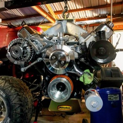

Working on a 440 engine build that will be installed in my 66 Coronet later this year. The oil pan on the engine in the car now looks like it came off a 4x4 pick up truck that went through a war. Going to replace it and could not help noticing quite a few cheap (under $100.00) 7 quart pans listed on ebay. Anyone have any experience with any of these in regards to fit or function? I figured I would ask before ordering a Moroso or Milodon. Thank you
