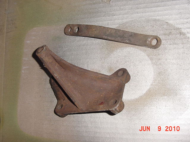

Looking for a picture of the a/.c bracket for the alternater for year 67-68 for the 440.I think they changed the bracket in 69.In 67-68 did the 383 with air use the same one as the 440?

Yes 67-68 are the same 69 is on it's own.
Here are some pics from a thread on another Mopar site on the same subject.
The alt. brackets are the same for 383 and 440, a/c brackets are not
