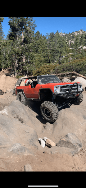

So this isnt a B-body. Its actually not even a car....

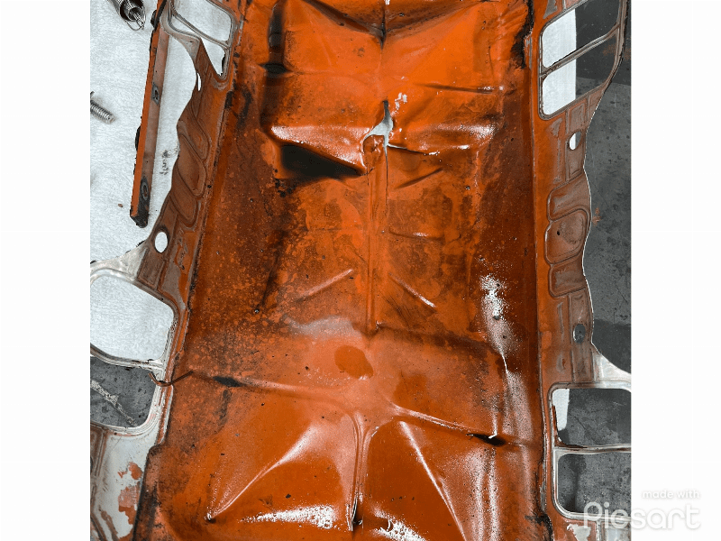

I swapped in a 8hp75 out of a 19 ram and was doing, lets call them "test passes" on the street nailing down some WOT shift patterns and sprung an oil leak, came to find out it was the intake valley pan. I had the stock sheet metal one in there, looks like someone shot a soda can with a .22 just popped it right in the center, so i ordered the nice stainless one from Hughes, but is it just excessive crank case pressure?

How about a picture? A crankcase explosion would have bulged everywhere not a single hole such as you have. Did something break and cause said hole?

Blew in the reward cylinder area. admittedly i mangled the pan a bit getting it off

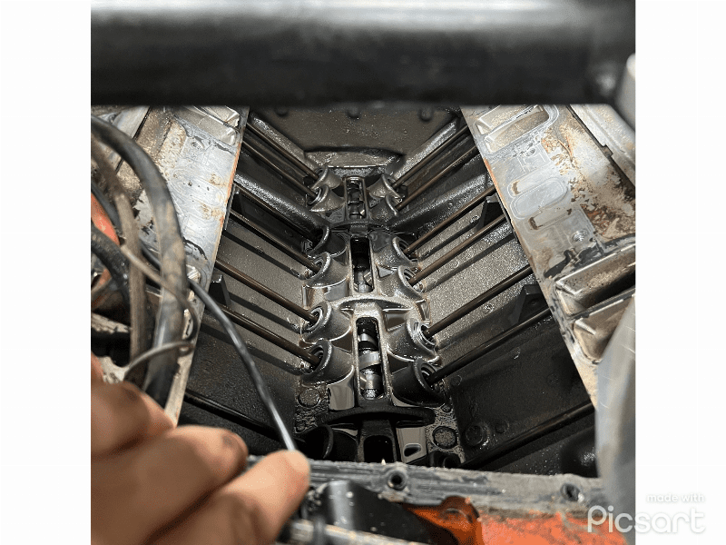

Valley itself looks fine, no carnage, no noise, under low RPM there was not even any oil spillage, just when she was spinning north of 5k

Even with a stuck PCV valve this should not happen. A properly sealed engine ring wise should not create enough pressure that a vent cant handle. Only way I have seen them pop up is extreme crankcase pressure due to a hut engine or an internal explosion. Those usually caused by gas in the fuel creating an extremely ignitable vapor that rises to the upper parts of an engine. Anyone that has done oil pan welding repairs can testify to that. Valve covers by design are stouter and do not yield to the external pressure where a valley pan is more flexible and succumbs to the pressure.

From what i can tell in the valley, cylinders, and oil this is a healthy 440 that should live for a few more seasons.

In other news the Hughes stainless valley pan was a really nice piece, very impressed. Hard to get a good picture with all the tube/accessories in the engine compartment
