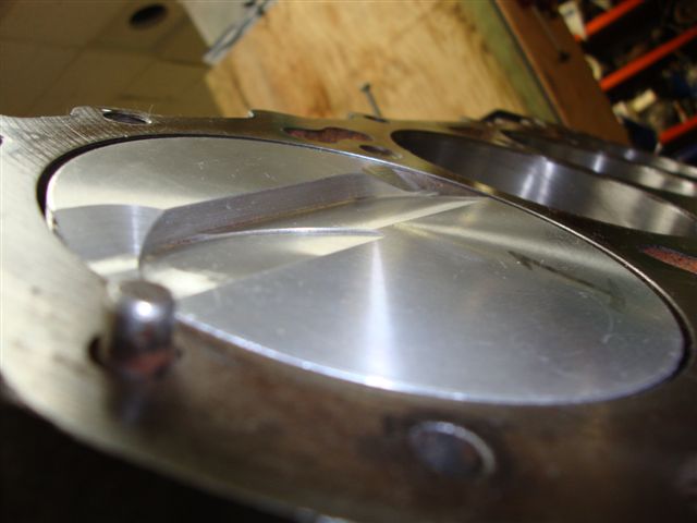

I CC'd everything and that's what I got. My heads are 915's with 2.14/1.81's and I think the Chambers came out to 79.5 CC +/- .3CC - or whatever the book says the 915's should be. My block has some huge bore chamfers - and when I say huge I mean HUGE - and the pistons have large valve reliefs that look more like a deep groove cut across the piston top. KB237 pistons (see pic). My cranking pressure with the MP .455" / 272 cam is 190 PSI. I believe if I had minimal chamfers and factory style six pack pistons that are more of a flat top profile I would have 10.5 - 10.7:1.
Forgot to attach pic. Here you go.
....Since we're on the subject, this is my 440 with the KB237's at TDC. If you look closely you can see the huge bore chamfer toward the top of the block in the empty cylinder behind the piston.

Wow....the bore chamfer doesn't look too drastic but the piston does. Man, that's a canyon! Might think about rounding the sharp edges a bit too. Uncut closed chambered heads usually do come out right around 80cc....I think the old books I have say 70 and I've also found the same head to vary as much as 5cc from one chamber to another. The pistons in mine are flat tops with no reliefs....
