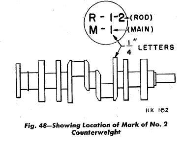

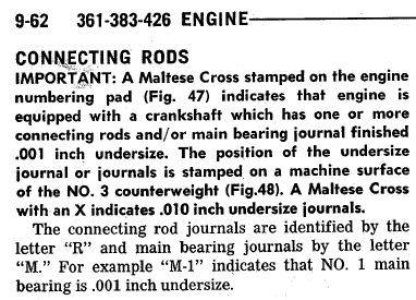

Yea, Meep, I think I might have asked this before because I am getting about .0025" everywhere with Plastigauge, and I thought maybe I should tighten it up with .001" undersize bearings. I had suspected this crank might have been cut .001" under at the factory (some where) although the block does not have the malteze marking for that (could be it's not the original crank though). So you think that as loose as .0025" would be okay?

Yeah, .0025" is fine for a MoPar. Running a high volume pump MAY help IF the oil demand is high, otherwise the extra volume just goes out the pressure relief valve. I have a standard volume pump with a 70 lb spring on mine and I think I'm at .002" - .0025". The Maltese Cross marking I believe means .010" under, not .001" under.

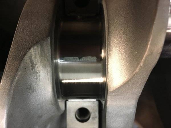

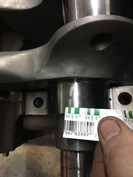

I realize this is an old post , but can anyone concur the rod and main bearing clearances using plasti gauge on a 440 -bored .060 with a high volume oil pump .
432 Stroker
440 Source Kit
Block was line bored , using 440 Source billet steel main caps
I'm running .002 - .003 , standard factory 440 journals. I have 85 psi cold and almost 60 psi hot with a high volume pump using 10/40 full synthetic

Had a Maltese cross on a motor crank was -.001 number 5 main and -.001 5/6/7/8 rod journals. Crank was stamped outside of a counter weight M 5 R 5 6 7 8. So you need to check the crank. Can supply a picture if needed.
yes , i would like to see that pic . thank you

432 Stroker
440 Source Kit
View attachment 569378 View attachment 569379
Same here as I use a 440Source crank and their billet steel main caps. Mine are all at .0025 to .003. I use Valvoline 20W-50 VR1 racing oil and even hot at an idle it carries about 40 lbs at idle and about 70 driving down the road at higher rpms. Ron
