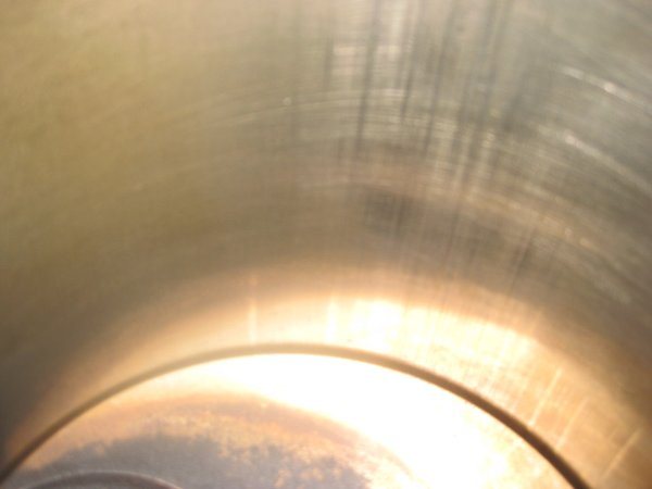

Does anyone have an opinion on the looks of these cylinders. They are from a 10 year old rebuild but I have no idea of the milage. I will probably have them re-honed because of the vertical grooves but I'd like to hear from someone who has seen more cases of this as to how extensive this damage looks. Thanks-

I agree, doesn't look too bad if that's the worst cylinder. My guess is it got really hot a couple of times.
it looks ok from what i see unless its glazed over but other than that its ok
Thanks for the feedback, I guess I will have it honed since it's out of the car.
