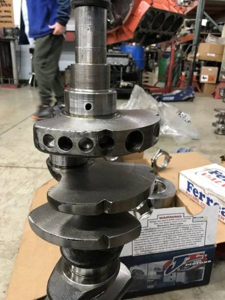

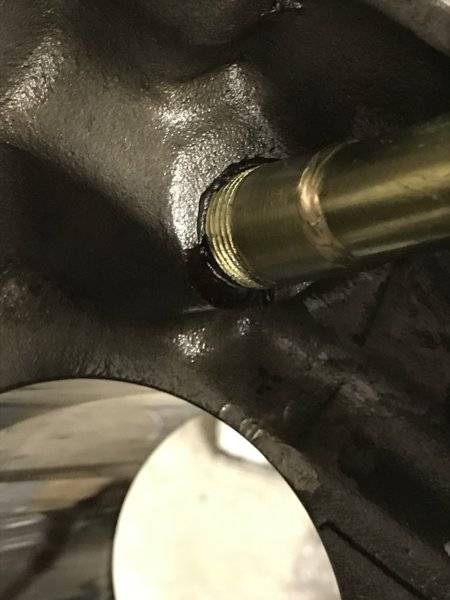

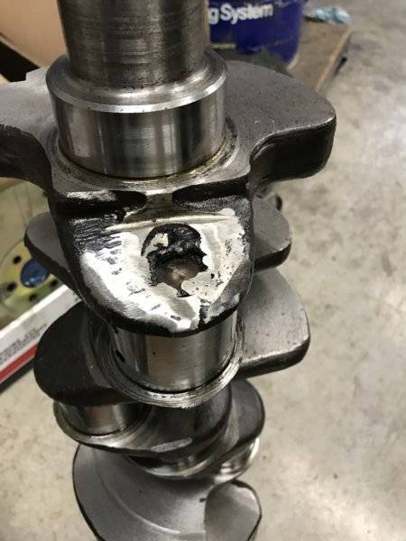

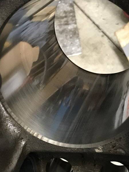

I have just returned from the professional engine builder i am now using who has told me my engine is junk.
In 2013 I bought a 727 from a member here (or possibly former member now), and started discussing engines. He claimed to be a builder and could easily build me a 440. I entered into a deal with him shoveling him overtime money as I could afford it. Approx. 3 years later I had a finished engine and I traveled to Washington to help do the break in. I then stored the motor and installed it summer of 2018 and finally drove the car this last summer. I had maybe 200 miles on it when a rocker arm broke and bent two pushrods. I took it to the new builder who is a professional to diagnose. He tore into the engine and discovered a lot of sketchy work. The enlarged oiling boss from 3/8 to 1/2 cracked the block and was glued, the crank had material ground off and had been welded on! (pics).
I had approx. 6gs wrapped up in this build and now everything minus the rods and external parts are junk. I am looking at spending another 6-8 to make it run again. I’m at the breaking point. My wife wants the car gone. I’m beyond pissed.

OK, so everyone is doing a Monday morning quarterback on what the OP should or should not have done. Fine, but the real question is, what is his path forward from here?
So is the entire engine really "junk"? Why did the rocker break? I think you should take some time, if you haven't already, to determine what is usable and what is not. Are the cam and lifters OK? What about pistons and rings? If the machine work on the block is OK then it should be able to be reused.
If you haven't already done so, I think you should spend some time to understand what is salvageable and what is not before you declare the whole engine a lost cause.

Lesson learned the hard way I’m sure but never take anybody’s word when it comes to engine building. As far as the pickup hole enlargement
Drilling and tapping a NPT requires the correct tap
and drill as well as a taper reamer to be done correctly. Looks like the hole was too small and the casting was busted by the pipe tap.
