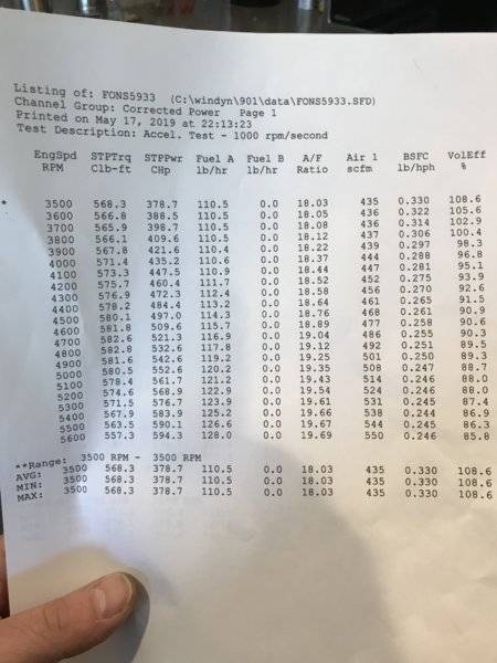

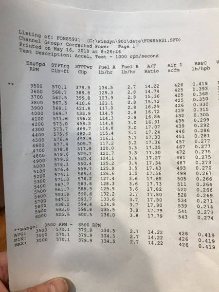

Dyno sheets
EFD6A820-D704-447A-89CF-86079CD93CA9.jpeg 834591DF-B8CE-4D09-B2D3-817402B4C15B.jpeg

When you run a test at a rate of 1000rpm/sec, the air and fuel turbines lag behind quite a bit........ but I don’t think it would be enough enough to show the A/F ratio as being 5-6 points too lean.
I don’t know where the dyno is located or what the elevation is there....... but that sheet shows about a 17.5% correction factor(139.8lbs/hr, bsfc .274 = 510.2 hp), which seems pretty high for this time of year.
Edit: googled the zip code...... looks like the elevation there is a nominal 750ft. So, only about 250-300ft higher than the dyno here(if that’s the town where the dyno is).
I’d never hand a customer a dyno sheet like that, with really odd A/F ratio and bsfc numbers.
Well, obviously the fuel flow is way off.
You’re not going to make 510hp from 139lbs/hr fuel flow....... well, not for long without torching parts.
The bsfc is merely the result of the “observed” hp and “measured” fuel flow.
If the measurement is wrong, the bsfc result is also wrong.
However, even if the fuel flow reading is incorrect, you can still determine what the uncorrected power was as long as you have the measured flow and bsfc result........ since the computer is just basing the bsfc off those two things........ observed power, measured fuel flow.
Obviously, if the load cell calibration is off, then the observed power is off, and the bsfc will also be off.
I don’t really like to comment on dyno sheets like that(because I come across as being “sour grapes)........ but that one seems to raise more questions than it provides answers.
Right. One, or the other, or both are wrong. And fuel flow is not complicated. And usually there are two. And where is the dyno operator fixing this stuff? Based on what I see, there isn't any reason to believe any of it. It started at 525, and the operator tuned 75 HP into a customers motor, but allows data like this? Hmmmmmm
I’ll just leave it at ......
If I dynoed it here........ there would be a lot of different looking numbers on the dyno sheet.
