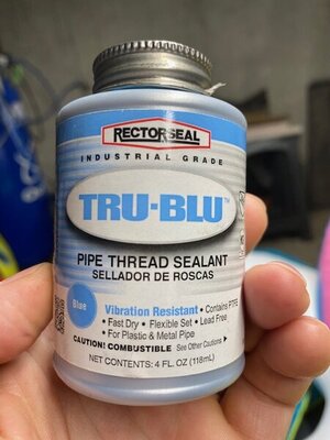

If you have not yet solved it, this is what I used just a few weeks ago. It worked like a charm, so far. :). Best, B.
OH, Stock Iron heads. The nasty bolt in question was the Front Driver's side. Best to you, B.
