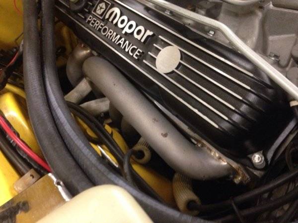

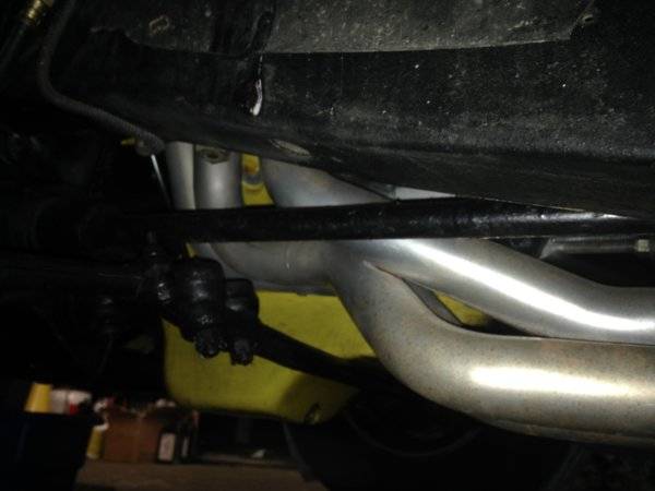

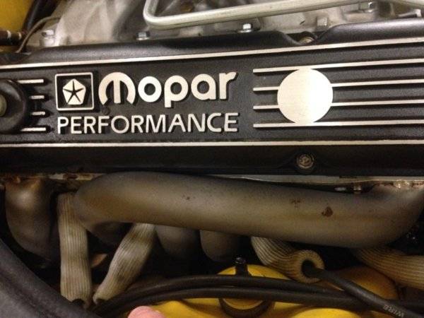

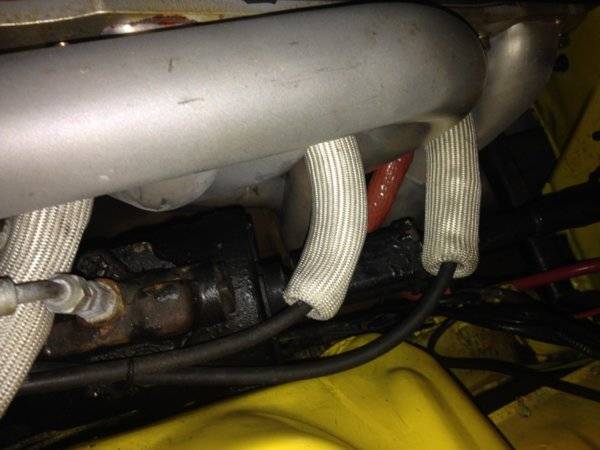

Those are the 2" primaries coated. I use the plug wire covers to keep the heat down on the boots and wires.
Great pictures, thank you.
It's nice to see how they fit around the suspension and the torsion bars.
I like the plug wire covers too. Good ideas.
(Nice charger color)
Yea they fit really nice around the lower suspension gear.

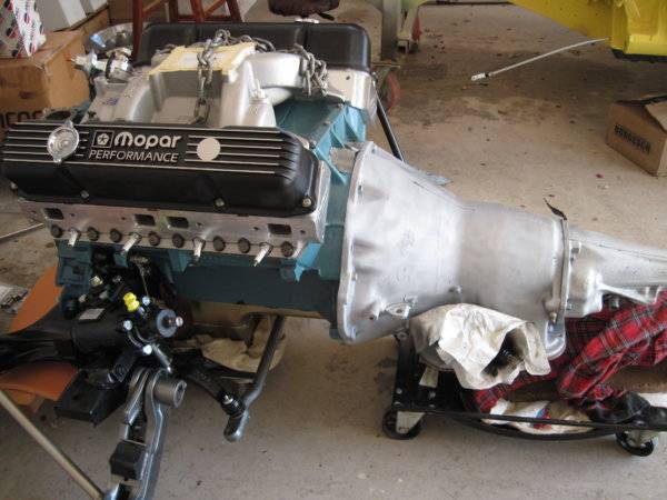

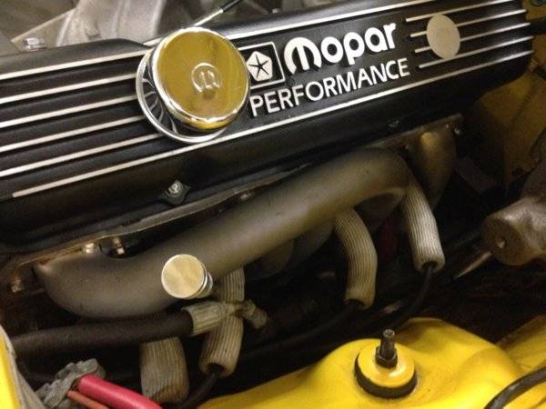

After getting advice and help from many of you on this site, I decided to spend the money and get TTI headers that are made for and fit my engine and car. They look great and seem to fit well and I don't regret it. I will leave them off until I break my engine in. For engine break in I will temporarily use my original exhaust manifolds and some pipe to take that first hot run.
