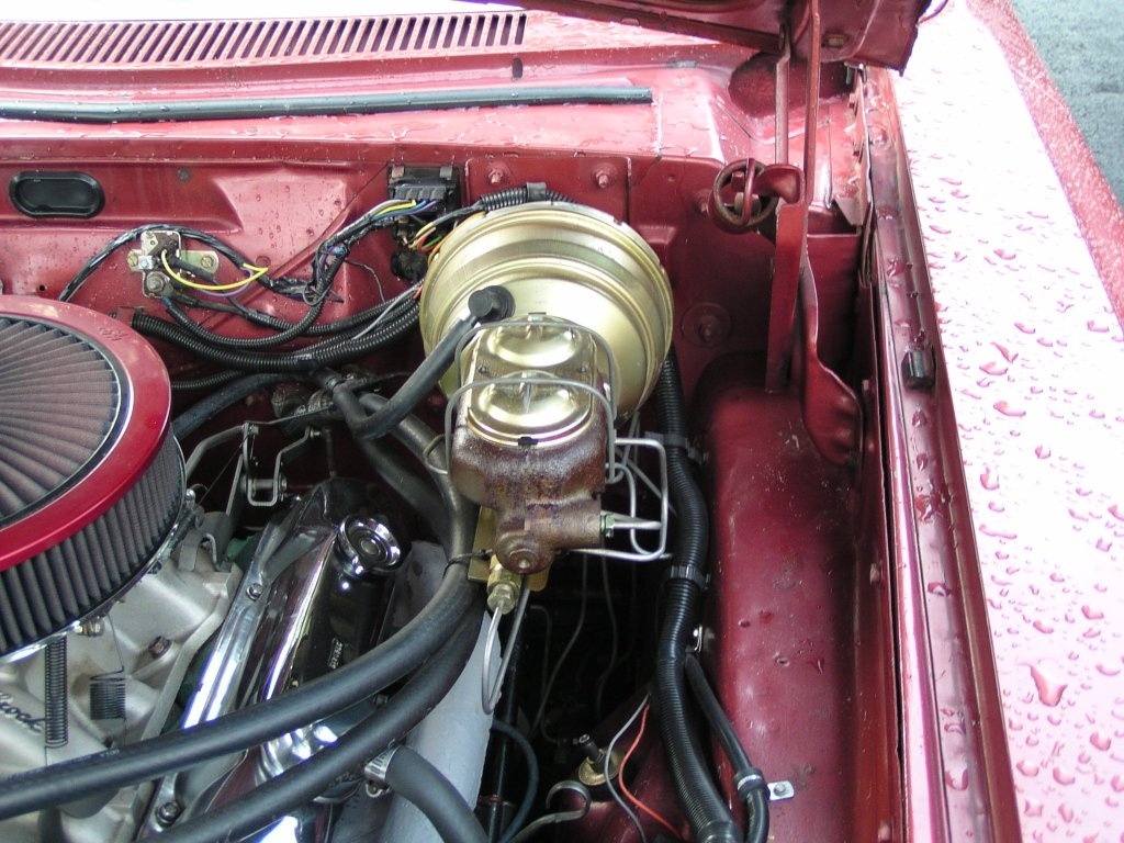

Btw, appears you converted brakes to dual master cylinder. Discs front, drums rear ? If so, what master cylinder ? This 65 I acquired has pwr w/ discs front, drums rear. I don't like the setup. considering removing the pwr and going with an SSBC propotioning valve for rear. Used before when I redid the brakes in my 64 wagon and never had a lock-up whereas the present set-up is too sensitive. And, I want to use a line-loc for front.

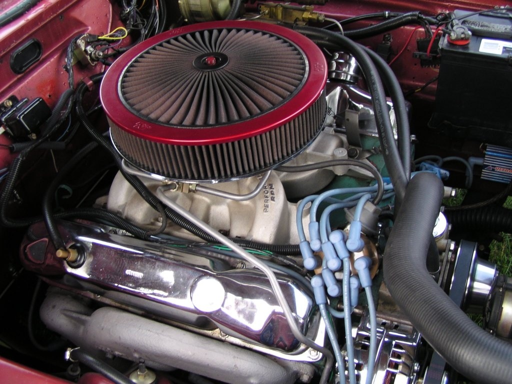

Here's fit in my car.
Thank you !!! Awesome setup ! Super clean engine compartment. Incidentally you seem to have gotten everything I want to do in the not to distant future.
Swap old Mallory ignition for MSD with 6AL box . You are not running a vacuum advance ?
Carb is Holley ( CFM ? ) with manual choke ? \
I have Be Kool radiator , with electric fan.
Dual master cylinder ? Wilwood ? Kit ? Dics front, drums rear ? I see a line loc. Exactly what I want ( have it but not installed.
Battery in trunk . Again , awesome !
