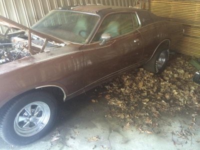

Hello all,
I am new to the forum and wanted to get some advise. I am in the process of buying a 1976 440 motorhome engine from a guy i work with for $400 for my 1972 dodge charger. I'm supposed to look at it this thursday and as long as it isn't a boat anchor i'm probably going to buy it. Odometer on the motorhome said 45000 miles when they took the engine out. I already have a Edelbrock Performer RPM Intake (Paid $50 at a swap meet) and a set of headman headers for a b body (also paid $50 at a swap meet). I have a 2k budget for the rest of the build, what do you recommend for Cam, Carb, torque converter etc. I already planned on buying a MSD Ignition kit. looking to get 350 hp and over 400lb/ft torque. My charger already has a 727 and a 8 3/4 rear end.
