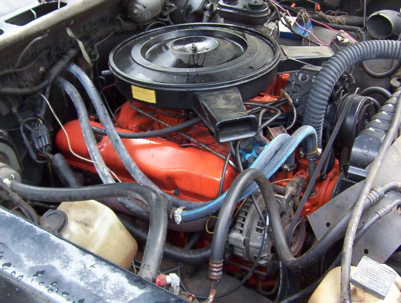

I bought a D150 from a friend of mine who had installed a 440 from a motor home in it. He said it was a 77 ish year & had about 70K miles on it. Has a normal legnth 727 trans on it. Not the shorty. He put new gaskets on it & painted it orange. It looks darn good in there It runs good. Has good oil psi. No noises. So I was wondering what the rated HP & torque of this engine would be. Its got a thermo quad on it. ANyone know? I have always heard the MH engines had lower HP, but more torque down low

I don't know the numbers, but the truck motors don't have more torque down low, it's just that their torque isn't so bad as their horse power. I'm running a low compression 413 in my 69 belvedere and it gets out of its own way pretty good, used to destroy old MT Sportsmans in 1st and 2nd.
As HT413 said, they don't really have more torque, they really just have less horsepower haha.
I don't know the exact number but its around 220-230. If you want to hotrod it they will make power, not quite as much as the earlier engines with the same mods, but they can run well. It really won't run much worse than a late 60s non HP 440.
P.S. does it have peanut plug heads or 452s?
Yea I was thinking one of those mild Summit cams, swap meet eddy intake & maybe a Holley 750. I already bought a 8 3/4 rear from a 73 D100. & I bought a 3.91 sure grip from the guy I bought the truck from.
I'm not sure on the heads. If that's important I can check.
I think it's a GREAT combo for a truck. Nice cam and maybe a nice dual plane manifold and some headers and I bet you'll have a real beast.

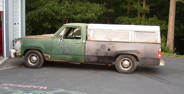

I put a 75 440 auto in a 72 D100. Came with a 3.55 open rear 8 3/4. That truck would run 14 flat in the quarter mile. It was a wicked truck. It could pull a house and not breathe hard. It looked like crap and ran like hell.
Good times...

Either summit cam will work well and be an upgrade. The smaller one is basically an HP equivalent and will be a nice gain. The bigger one isnt too radical, but will have a nice lope and detract from low end slightly. Do the springs too.
Heads dont matter, just something you may run into when you go to change the plugs.
Yes I was reading over on the C body forum about a guy who put the big Summit cam in his C & was very happy with it. Like the was it sounded & the performance. So I figured the 3.91 would only help. If it's too much I can change it. I definately want to hear the cam & have some low end.
Oh yes I will do the springs.
