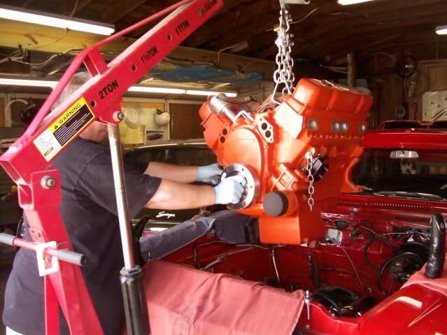

Beautiful. Like a big piece of orange candy...

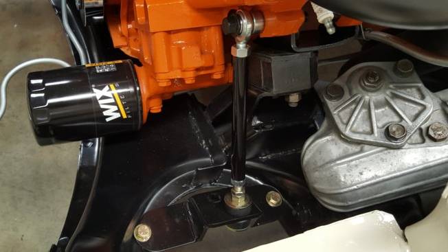

My set up with stock motor mounts and a Schumacher torque strap. Works great. BTW I found NOS mounts, made in the USA. Later ones were more troublesome with breaking.

Here's my Schumacher, modified E body kit I found on ebay for half the cost.

I was curious if you race your car or do hard launches with sticky tires ? I am wondering how strong that torque strap is if you use stock mounts with it and race the car ? It may be strong but it just don't look super strong to me but I could be wrong ? Ron

I haven't made any passes just yet. I just installed a new ring and pinion so that's prolonging any hard launches until I break them in good. Always something but the day is coming.
The torque strap is really beefy. I would be more concerned about the ear on the block holding up. It's an auto so no bang shifting like a manual. Maybe South Mountain next month if I can get some more miles on this gear set.
