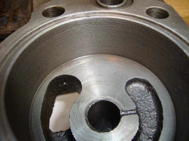

Hi everyone hoping someone can help me solve this issue . I've done some reading in a few places and thought I knew the issue to resolve tHe leak .
There is a filter leak of some type . First thing I did was check the filter to see if tight , then replaced with a new filter .
There is a small puddle of oil that ends up on my k frame that I keep wiping up every few days .
I felt all around the pump all the bolts the whole engine no leaks but a small amount of oil
Is always present every few days .
Double checked to see if gasket from old filter left behind nope .
Where the filter screws on is clean and shiny - maybe not sealing ?
Help
Thank you
Pete

Only thing I can think of is its all rebuilt and the surface where the filter screws in is warped ?
Guess it's possible. My pump is 48 yrs old.
Try this- put a layer of grease on pump and screw on a dry filter a little at a time and see what the grease shows? Never heard/seen this kinda problem.

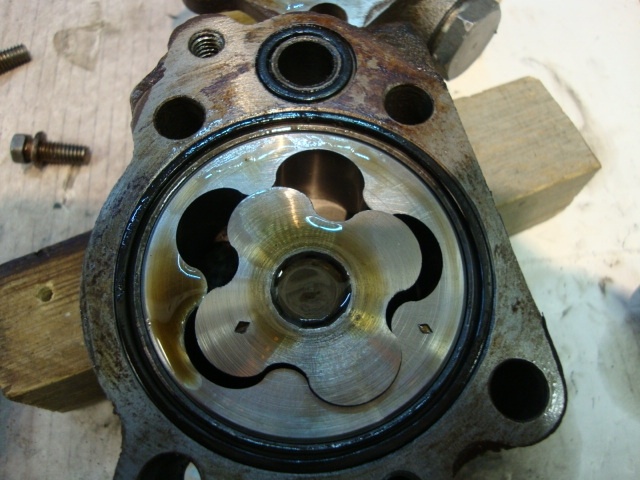

Oil filter is the lowest point so the oil going to run there. I'd bite the bullet and pull the pump. replace gasket on block and the O-rings. Check for warped parts. I don't know how hard it is to remove a pump on a wedge I had to remove a pump from a Hemi once in the car.
Yes that's what I am thinking . With everything hooked up and in car not much room so it's a major pain . Ordering the o ring and gasket tomorrow after I dab a dry filter with a little grease
To see how it looks also going to try a straight edge if I can .

Don't forget that o-ring on the housing that goes inside the block.
it's not too bad taking the pump off...a little bit of finagling around the sway bar and it's out.
good time to check and make sure there is no scoring on the wall of the pump and the veins etc...
