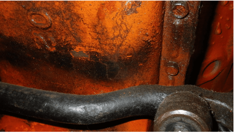

Should be on the back bottom, by the center link. Big numbers, hard to miss, unless they aren't there.
I haven't looked at the part # yet. Is it on the outside or inside of the pan ?
......Is it on the outside or inside of the pan ?
Lol, for example, here's the 02 of a 402 pan. Ya' can't miss numbers .......... provided your the pan has them.

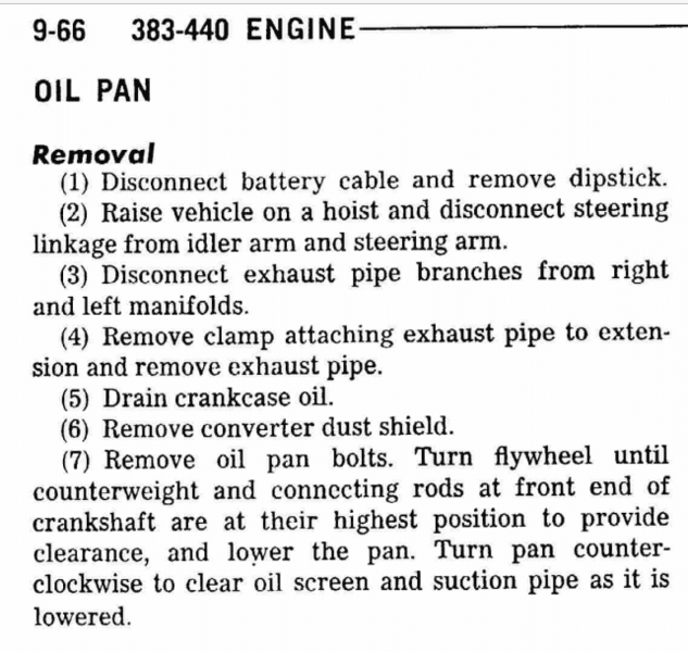

From '70 FSM.........
