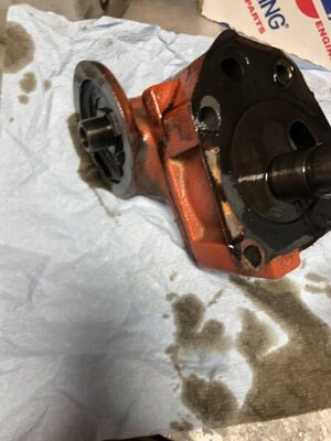

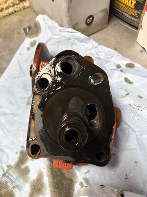

New build with 100% done in the yard except shopped a crate motor due to time constraints. Winter went fine, but just real unhappy with oil pressure dipping down towards 6 psi on a soaked hot idle. Went ahead and got a new 63HP pump and found this on removal of the crate pump. I know it won’t help the idle pressure, but damn I paid a lot for this motor to find this.

Besides the gasket being up-side-down, was the "O"-ring installed on the shaft? I can't tell from the photos?
If the "O"-ring is missing, the pump will try sucking air on the pickup side of the pump.
Oring good, gasket backwards blocking +/-30%. Yea, e-mail going in the morning.

Good luck but I doubt that is the cause of your 6 psi oil pressure.

Whoever did that one looks like they didn't even bother to disassemble and clean
the housing.
