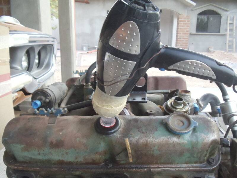

Plug the breather. Apply low pressure air through the pcv opening in the valve cover. Spray the motor with soap water. Watch for bubbles. This method is foolproof, cheap, and easy.

I used hair dryer with the soapy water and found an oil pan gasket leak:

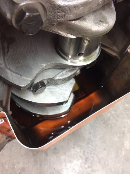

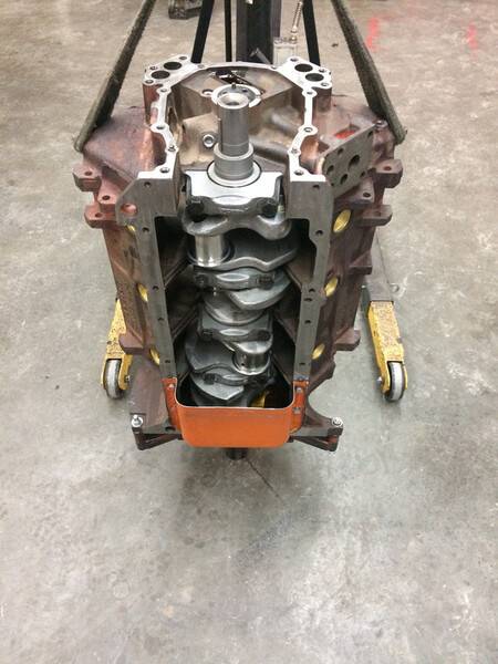

We do this for a living.... so we are supposed to act like the professionals at this ? and we Dyno everything in front of the customer before it leaves....
just say'in here....
so pretty darn embarrassing if the rear Main 'leaks' while we're putting it through it's paces on the Dyno ?
And it doesn't matter if it's a $40K HEMI or a $8K resto style 440 Wedge... same thing.
So during engine assembly.....
we STOP with just the Crank installed before going any further, install the Oil Pan and fill with Oil... then HANG the Engine off it's front therein completely submerging the rear main in Oil !
Come back in a while, because if it's gonna leak you will find out right then ! You can even turn the Crank a few rotations and see if you can get it to leak ?
Then.....
If all Dry ?
remove Oil Pan and continue assembly
If leaking ?
remove Oil Pan, Crank and Seal and start over.
