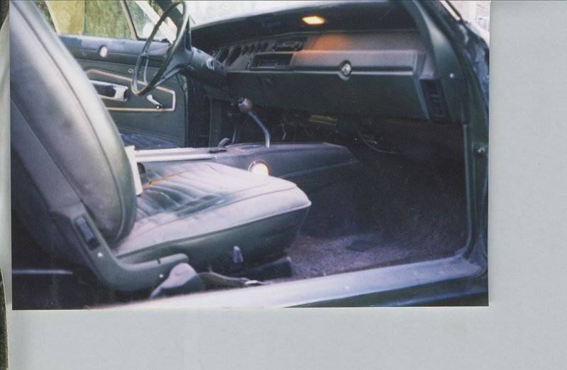

                My car is a 500 model, it came stock with bucket seats and a floor shifter. You will need a linkage set for a 66-70 B body. 00000020.JPG
