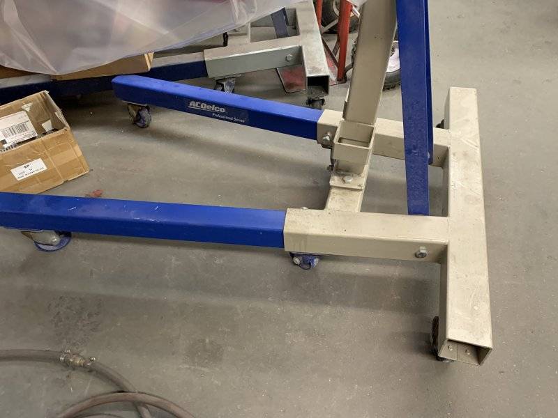

Go with the 1000lb FOUR wheel stand. Avoid the 750lb 3 leg stand for your safety. I prefer to use the 2000lb from AC Delco for 2x safety factor.

We added a stiffener to this one. I cut a board to stick under the front otherwise it's still a bit springy
