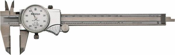

I can score myself a decent micrometer. Which type did you use? I've used these in the past but don't want to spend $300 LOL
That’s a Caliper. I have a blue-point one. Which is SnapOns low-line.
